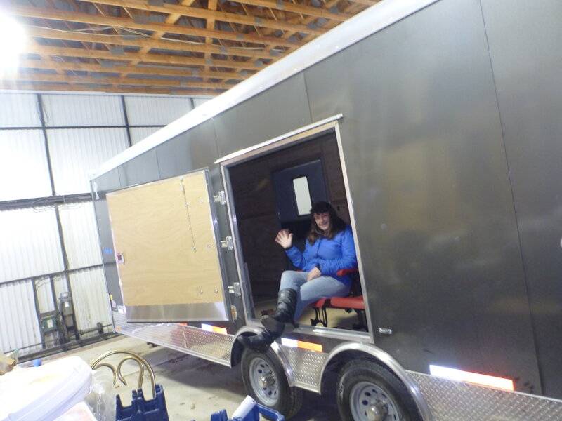

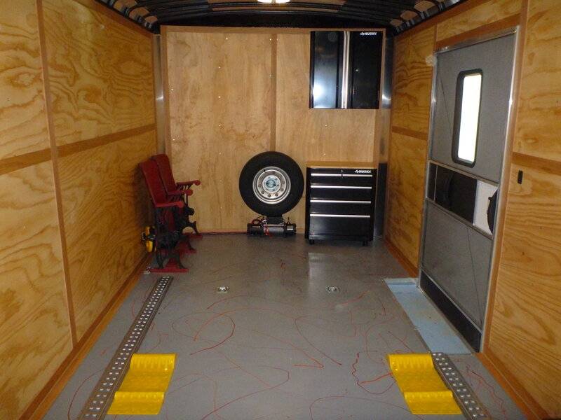

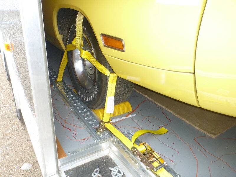

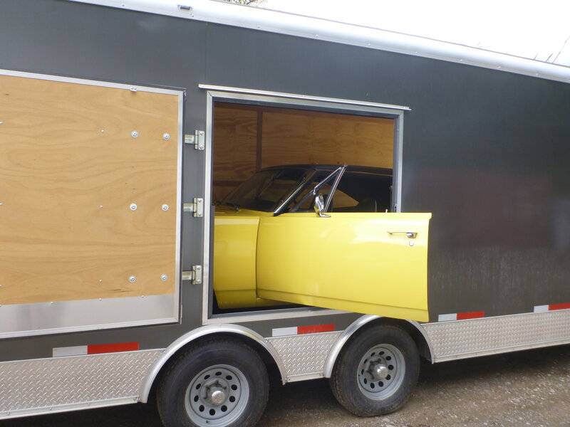

Hope you've got a drivers door, winch when she decides to die on you and good easy tie down solution.

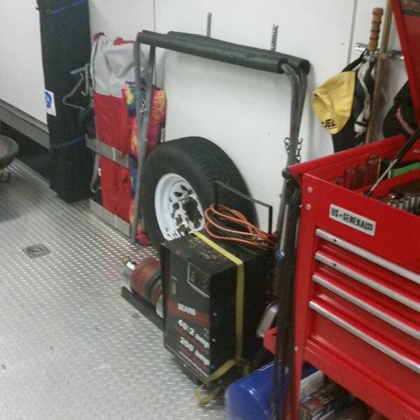

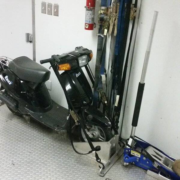

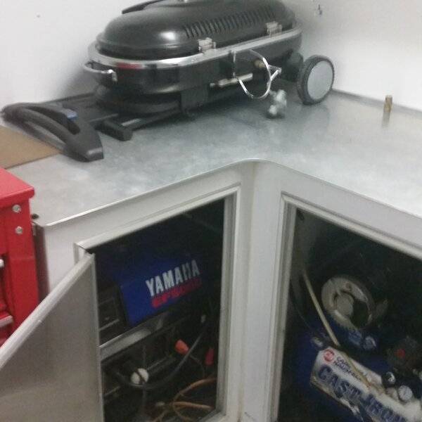

Not one, but a series. Make mounts and brackets to hold everything. Picked here. Tool box is bolted to counter, grill is bracketed to counter, both with nut zerts. Spare, fixture for holding the hood, spare, chairs, EZ up tie down straps, all have wall brackets. Battery charger and scoter both have floor brackets. Everything has a place.

Wouldn't own a enclosed trailer without a driverside escape door.
My fat *** has a hard time getting in and out WITH one !

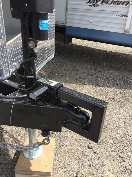

Electric jack. Always on sale and quick install
Locking devise. I welded a receiver onto my hitch. Then made a 2X2 that slides in, locks and blocks the ball and hitch. I also added a tube that protects the locking pin. Thieves can’t slide a pipe over the locking pin to snap the lock off.

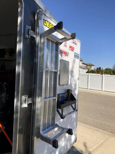

Step. I bought my trailer without a step well. I picked up an aluminum step that was on sale and shortened the legs. My dorf step. It hangs on the door. The step is always the first thing off and last thing on when loading / unloading.
After 100 times in and out of the trailer in a day it becomes appreciated.

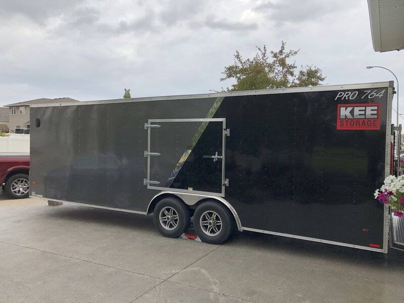

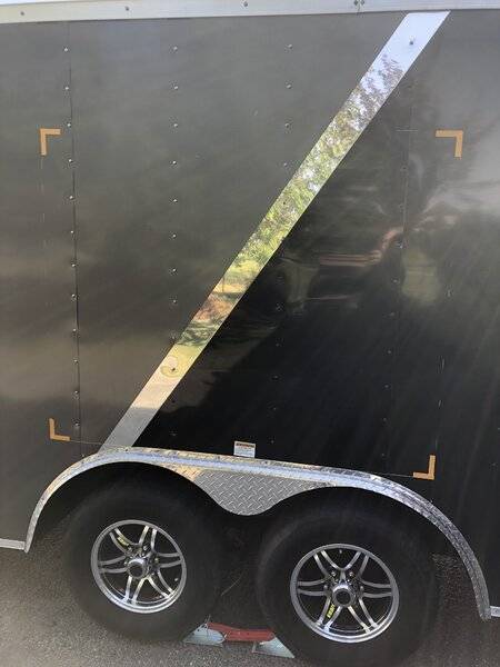

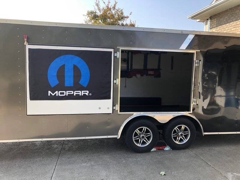

Driver’s side access door.
Just finished adding this door a few weeks ago. Have yet to use it but I truly regret not having it added when ordering this trailer back in 2014. It was a fun project and addition.

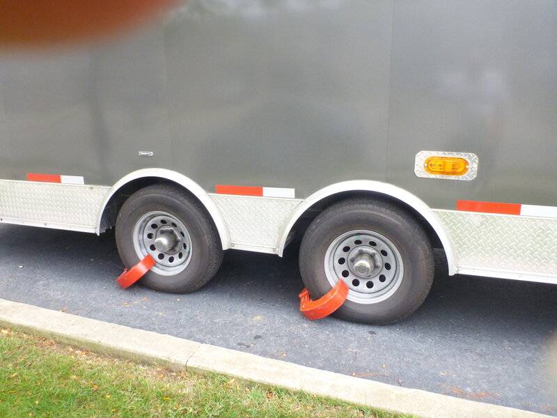

One other thing I do is use the winch to keep side door closed from inside. I have a clevis bolted to the door. Use my remote winch control and bump the in button until I see tension on the door. Use the out button before opening. I also have slide locks on the rear door with padlocks from the inside. Even if someone cuts the locks on the outside they are not getting in. I also have a chain run thru both wheels and padlocked for another deterrent.
