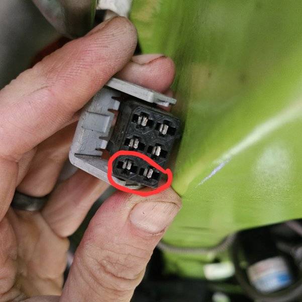

I checked my connections. In looking at the connector that the O2 sensor plugs in to, two connectors looked like they were a bit receded back into the plug. It wasn't super obvious, but they looked funny where I was now looking at them critically. So I went through and made sure all connectors were well seated in the plug.
The picture below is after I pushed them back into the plug, but i believe the circled ones were not making good contact. This meant there was no error because the computer saw a working sensor, but the sensor wasn't reading it correctly.

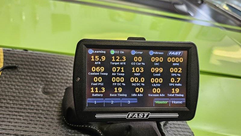

Once I pushed them back, I was able to get 15.9 to 10.0 AFR by letting the O2 sensor hang and then wrapping a carb cleaner rag around the it. Below is a picture of my computer showing lean.
I started the car and suddenly it is idling and behaving like it should. My issue might be fixed!
