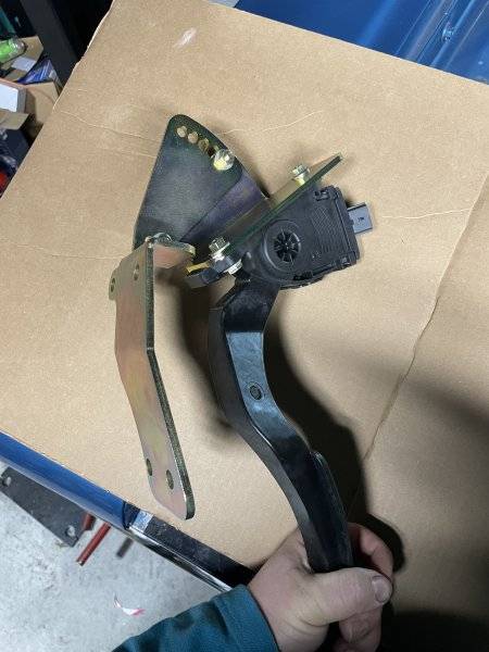

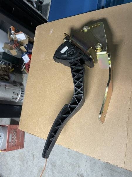

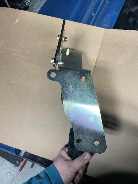

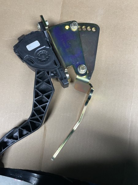

Just saw in the new MCG that USCT makes a mount/adaptor for the required pedal to fasten to. Several different configurations to be had for many years and bodies.
I have the USCT pedal bracket. I haven’t gotten to the point of setting the proper position in the car yet though. There seems to be a lot of adjustability and it feels solid and sturdy. Mounts in the existing OEM pedal holes. Did have to cut off some material for it to fit around the firewall wall portion of the USCT Trans Perimeter Frame.
