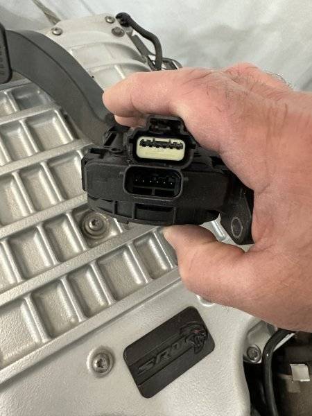

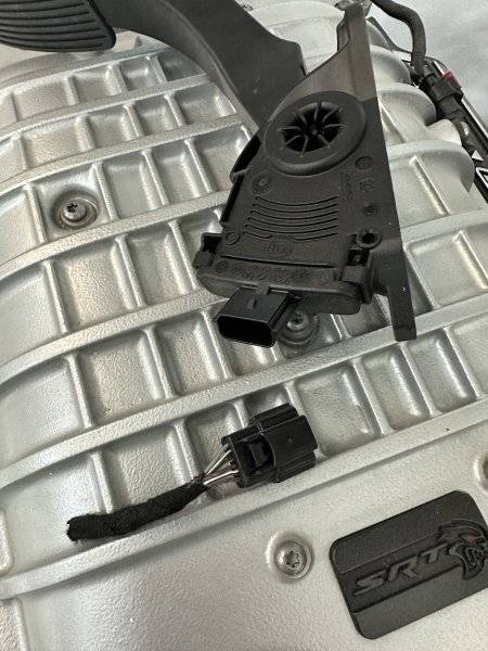

Is the the electrical connector you need? If so, let me know where to send it.
