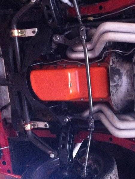

I'm gathering parts in anticipation for a swap from the Firm Feel Stage 3 steering box with Fast Ratio arms to a Borgeson unit with stock arms. This is in regards to my '70 Charger.
I have collected parts for years and most of it is UNmarked. In many cases, parts will physically interchange between A, B and E body cars.

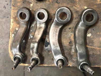

These are all the same sector size. Notice the differences:
They all appear to be the same length.
The two on the right have that banana curve but the 4 index marks are the same.
Could all four of these be for B body cars? If so, that is odd since I have parted out a LOT of A bodies and only one B body.

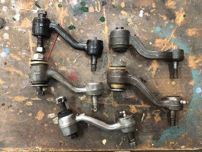

Check out the Idler arms....
If these are for an A body, It would be the 73-76 models since the early A has the stud pointing UP.
The two on the right are quite robust. ALL also appear to be the same length.

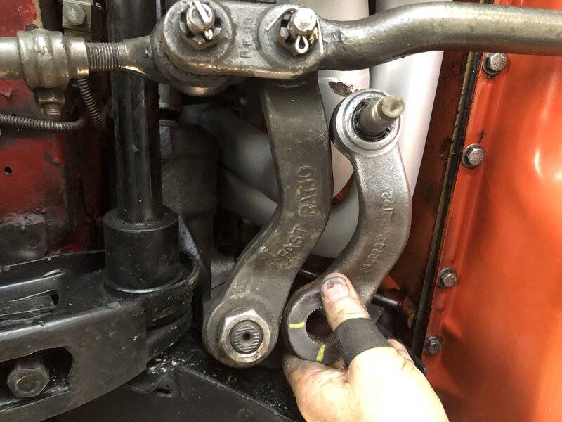

This picture below is with the Fast Ratio arms. Note the banana curve in the Pitman arm.
That at least leads me to believe that the two curved Pitman arms are likely to be correct.

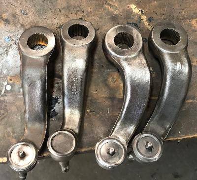

With that info in mind, the Pitman arms that I have are all small spline so that must mean that they are 1972 and earlier.
The 2 that I posted with the banana curve look like the Fast Ratio Pitman that I have.
