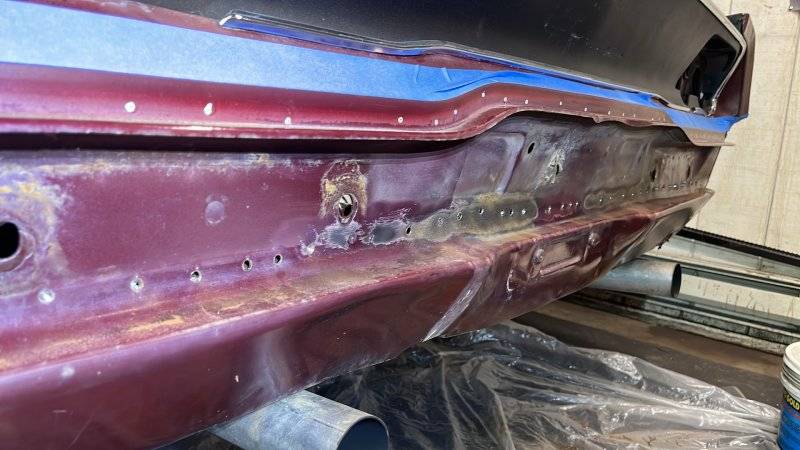

I’m in the middle of doing mine right now, to install a one piece trunk pan. I’m hoping to reuse the lower valance, so I need to be more careful than you. Locate and punch all the spot welds then drill through the ones between the tail light panel and the trunk pan. Use the spot weld cutter of your choice to carefully do the welds at the sides, the tabs that attach to the cross member underneath (bottom of the valance) the bumper brackets and the trunk lock support. Most of those attachment points (except the ones at the quarter panels) have thicker metal behind the valance, making it easier to cut the spot weld without going through. Then the valance should come off.
Since I’m trying to save the valance on mine, and I’m replacing the trunk, I’m waiting on the Blair style cutters because I’m not always successful with the other type, and I don’t want to go through the tail light panel.
Go slow, take your time and good luck! This picture was after I’d drilled the trunk/valance welds and I’d marked the tail light/valance welds when I’d decided I’d try to do them from inside with the Blair cutters (arriving tomorrow). The painter tape was my way to create a mental barrier to avoid going any higher - just ignore that!
