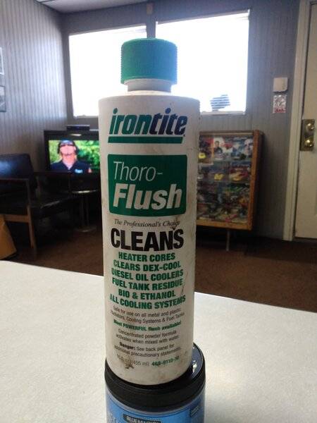

This is what I use at the shop. Best that I have found.
