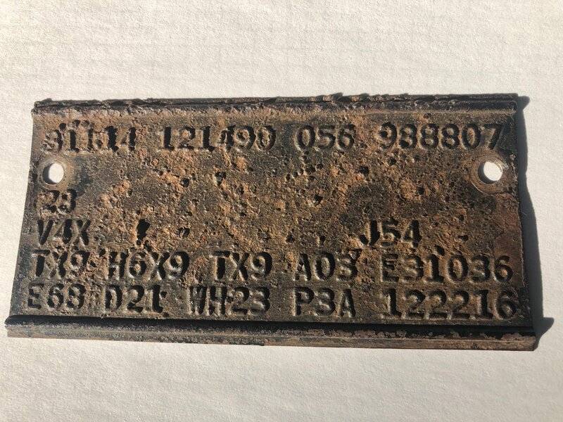

Do you have the fender tag?
Yes on the fender tag , very rusted and hard to read, what could /should I look for.
Do you know what plant it was built at?
7th digit.
If it's a Lynch Road car, the axle ratio will be part of the gate sequences at the top of the tag.
If it's not a Lynch Road car, it may have a code (starting with "D" IIRC) on the first or second line from the bottom.

My 73 Rallye 400 4spd has a 3.23 as I stated above. Bottom line of the fender tag is D21. All that means is a HD 4spd Man. When I tried to decode the fender tag, rear gear was not listed.

Thanks YY1 for that code post. I am trying to post my fender tag, its in rough shape. I also have D21 on the bottom, but that does not say what gear ratio. BUT, what is the difference in D 15 and D 21, did they offer two four speeds?
My fender tag....thanks Guys, what do I have.....
Lynch Road
numbers on top are the gate sequences, and your axle ratio/SG should be in one of them
I'm not a gate sequence guy though
I think it's the 056
I will go look at my lynch road 4 speed and see what I've got
I found some info on those sequence numbers. .my 74 is different because it's a 74..but 056 stood for 400-4 barrel without ac in 73. 988807 stood for axle ratio and transmission .i haven't found 988 but the 807 stands for b body 4 speed. .if your first three numbers were 992 then it would have been a 3.55 gear, so I'm thinking that 988 may have been something like 3.23
Bingo! Found it! 988 is 8 3/4 3.23 open diff with 10" drum brakes
Ha Ha awesome, thanks 400s. WOW, would not have thought that info was on the tag, great. I guess if someone decided to make tags that carry that info , someone kept track of it. It is a non AC car as decoded and does the tag support it being a Rally car. So this means I get to drive the car the first time in mostly the factory setup... Now, if it specifies a 10 drum....what other size drum brakes are/ were available.....thanks all.....
No problem! At least you know how the car was originally setup! Maybe some of them got 11" rear drum brakes but on all the 73/74s I've been around have never had anything bigger than 10"
