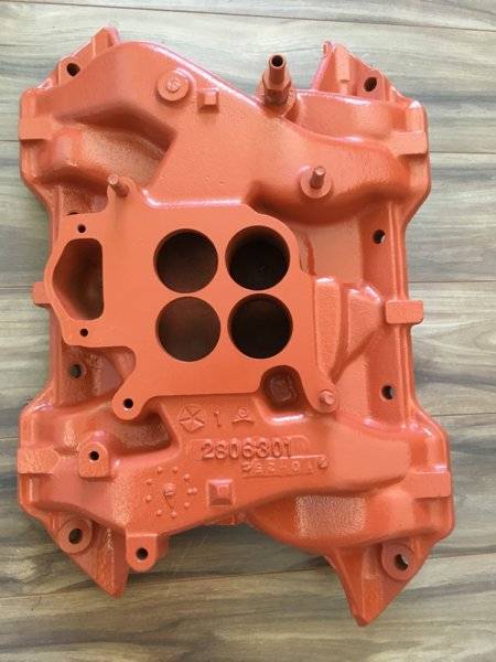

Depending on stock intake. 68/ 69 Carter AVS and 70-71 Holley 4160
Looks exactly like this one
