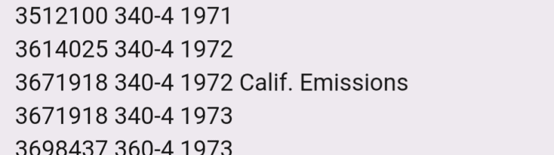

Is the 72 intake the same used in 73?
(Edit-Casting number wise, looks like no, federal wise.)

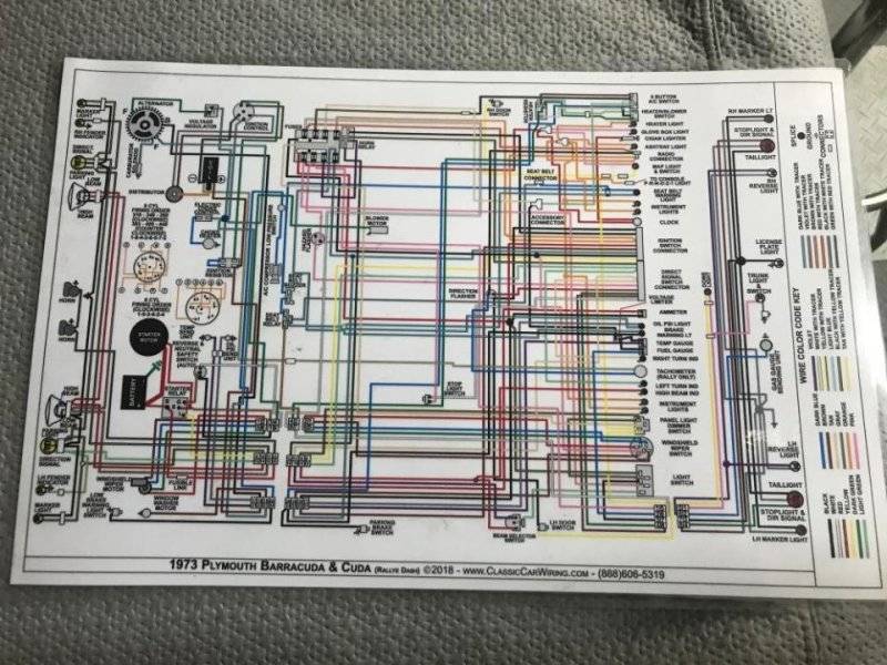

Can anyone determine from this wiring diagram where the choke controller gets its source of current? Can't tell if it's ignition switch, ballast resistor, or somewhere else.
Get whichever one you want. I always hated using the choke with the wire and not having it hooked up.

Most of the divorced, manifold mounted choke thermostats on 1973-1984 Thermo-Quads were electrically assist heated. The electric control of the choke heater is via the small module mounted to the intake or right head. This unit times the assist based on ambient temperature and run time. The unit receives power from the ignition run circuit and applies voltage to the choke thermostat electric assist. Four styles of electric control units performing a similar function were used depending on application:
- 1973-1976 single stage. Chrysler part numbers: 3656730, 3698357.
- 1974-1976 dual stage. Chrysler part numbers 3755750, 3755770, Auto-Tune # A32-901.
- 1977-1984 single stage. Chrysler part number 4049799.
- 1977-1984 dual stage. Chrysler part numbers 4049777, 4091034, Auto-Tune # A32-903.
The dual stage units have an additional external resistor compared to the single stage units. 3656730 or 3698357 is the original number for a 1973 340, but the later units will also function. The control units are not readily available in the aftermarket, but the units rarely fail in normal operation. My 1973 Duster, 1974 D200, 1977 Fury, and 1979 Newport all still have their original units with mileage ranging from 253000 to 380000 miles.
