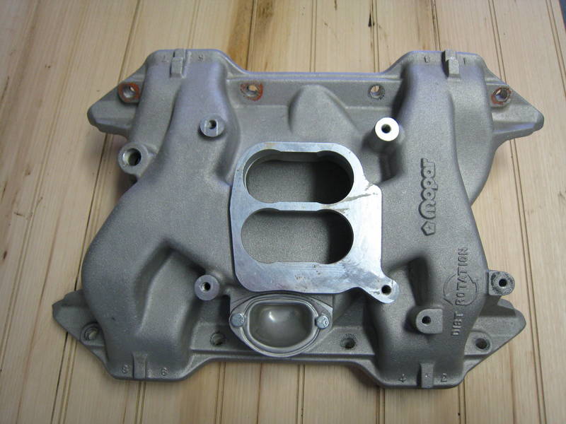

I meant Choke pull-off in the title, sorry
I have an old bimetal choke pulloff from my original cast intake I was hoping on using but unfortunately the 'cup' for it on the M1 is not deep enough to accommodate it.
I dont want to go manual choke so is there one that will fitor do I trim the old one to fit? (its the ring on the spring to adjust the tension that hits the bottom of the cup).
Thank you in advance for your input

Hey, I have one of those!
By choke pull off I believe you mean the actual thermal choke unit that sits in the well pictured above. Choke pull off is the little vacuum diaphragm on the carb that cracks the choke blade open just a little bit to give the engine some air when the choke is set. This intake is set up for the later choke unit (like the 69-70) that has the domed housing. See part number 653 here http://www.hoffmanswinnerscircle.com/cat08.htm
