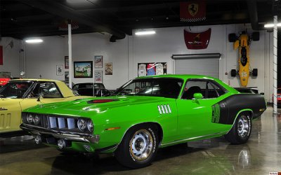

I wanna paint one of my mopars this color, i know its a sassy grass green but is it a specific type. its a very striking green!
Before you shoot the car spray some test panels to make sure it is the green you want. The paint used back then was single stage. Sometimes if you go with a base/ clear system it won't appear as bright as original. I did see a PPG rep spraying water based base paint and he did say that they will appear brighter than solvent base. I can not attest to this because I haven't shot any water based product yet. Good luck!
