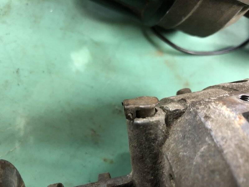

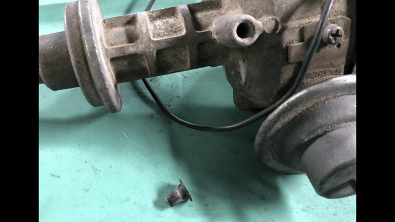

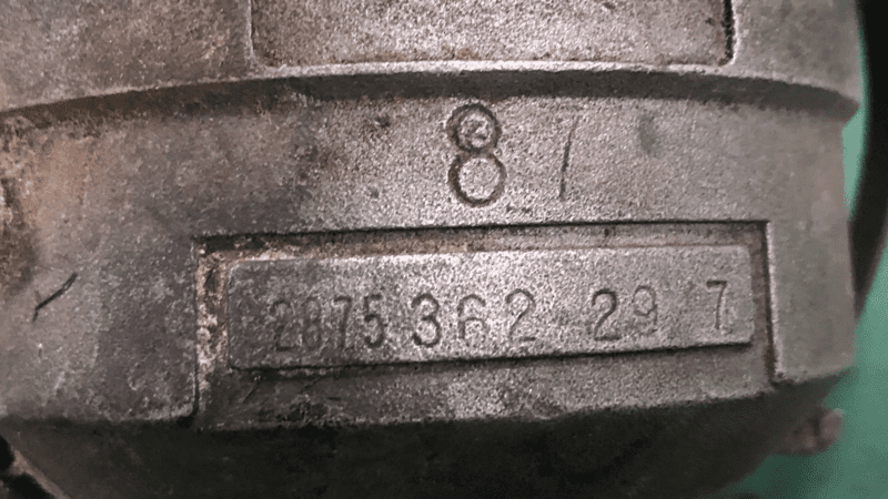

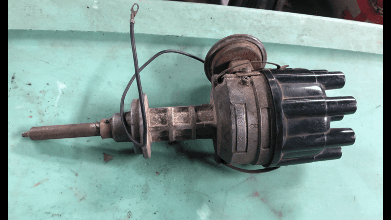

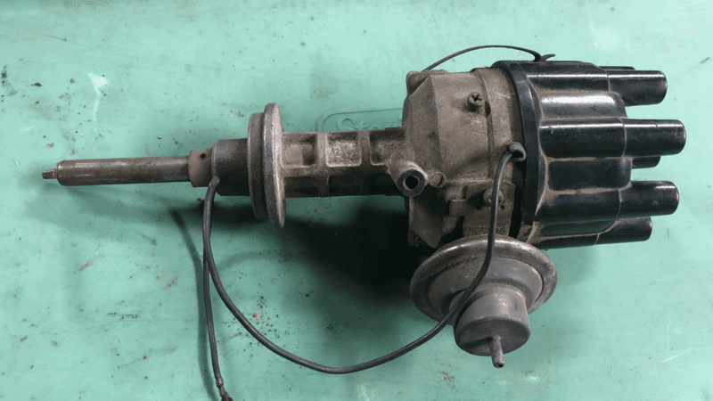

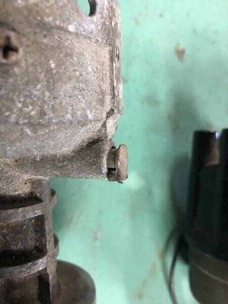

Garage cleaning today - Anybody know what this distributor is from? Is it worth a million dollars?
Its a shame the spring loaded oiling door is missing. I would have liked a good restorable core.
Yes, it looks like it was removed in the first pic.
This is on a 383 distributor, the 440 one has a plug in it. Not sure if it can be removed without damaging it.
Ok, interesting. I just assumed that all the housings that had the cast-in tube got the trap door. Thanks.
YEs a oil fill, the shaft will not wick oil up from the drive gears splashing. Have to go to the shop to ID it.
