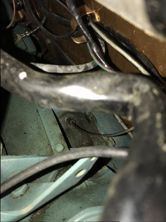

This is all I have in situ so I reckon I'll need to get a new pressure gauge, presume it goes in this same outlet hole and replaces the oil feed?. No idea what an idiot light is but I have a gauge.

There also should be a wire pigtail coming out of your wiring harness on the firewall right in that area to power it.
There is two ports there. You can run both mechanical line in one port and the electric sending unit in the other port. I believe they are two different sizes.
If you zoom on this pic you can see it and the wire running to it in the back on my car.

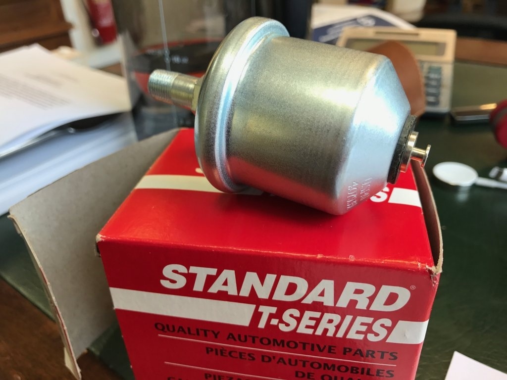

Thanks all, I got my lovely new sensor today and I was hoping to find the cables to connect it up just sitting and waiting for me, silly me!
It has an unusual connector at the top, do you guys have a photo of what this connector looks like and where it runs from the sensor into the firewall?
