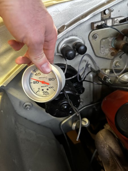

I just put 10w-30 in my 1969 383. I’m not sure what oil was in it before but I didn’t seem to have any issues. I hooked a mechanical gauge up and the line filled with oil and held 75 at cold temps. However, when the engine is cold now at idle I hold 28 pounds and the oil line to the gauge won’t be full of oil but has some like pictured if I hit the gas it’ll jump to 55, full the line and stay while on the throttle. When the engine is hot at idle the line isn’t full of oil like at cold idle and the gauge-sits at 0. Not sure what it’s like when driving and it’s hot as the gauge is in the engine bay since I just hooked it up. Could this mean I need a 20w-50 oil or could it be my oil pump or bearings? I don’t understand why I have no pressure when it’s hot and why the line isn’t full of oil
I would verify that that gauge is correct just to be sure. But it does sound like you have an oil supply issue. Its not the heavier weight of oil that's going to fix the problem. Zero is not good.
What's in that space that's clear in the oil line ? Does it remain the same, or does the size of the gap in the oil line change ?
I would say the increase in pressure compresses the air, causing the oil to more completely fill the tubing and vise versa at low RPM. Boyle's Law. Basic physics.
It changes. I assume it’s air? When I hit the gas the whole line fills with oil

Loosen the line fitting at the gauge and bleed off the air. It will be messy.
Mike
You will never bleed the air out. After the engine shuts off, the oil galleries drain and refill with air. When the engine starts up again, the oil pressure fills the gauge line back up with air. The gallery oil compresses this air to the same pressure as the oil, so the gauge reads the right pressure. There will always be some air in the gauge capillary tube. If you don't like to see this, put a copper line on the gauge instead of the clear plastic one.

And if that gauge is going to be on or in the car, go with a copper or braided line.
