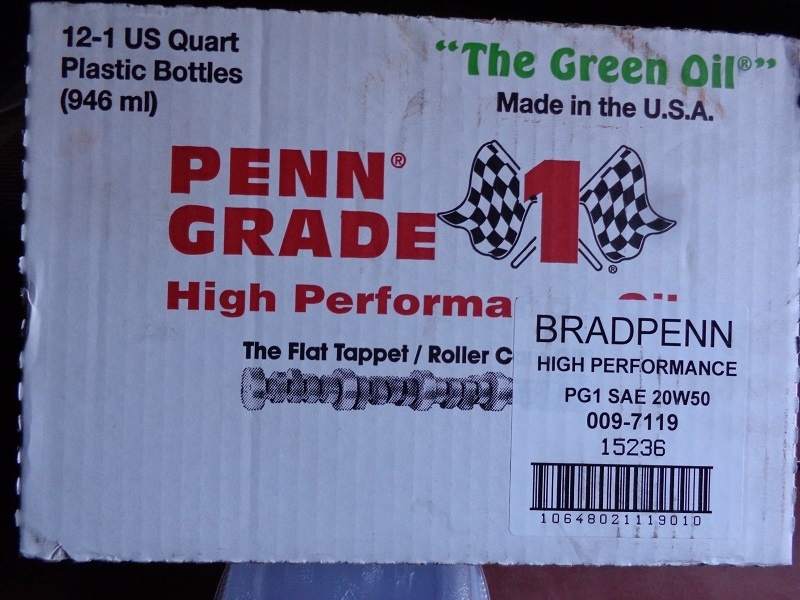

She's an old engine and I also have a friend real close by that sell this.
I also hear that engines will leak though gaskets quicker with synthetic oils. I don't know how true.View attachment 385934 .
