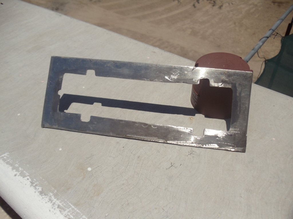

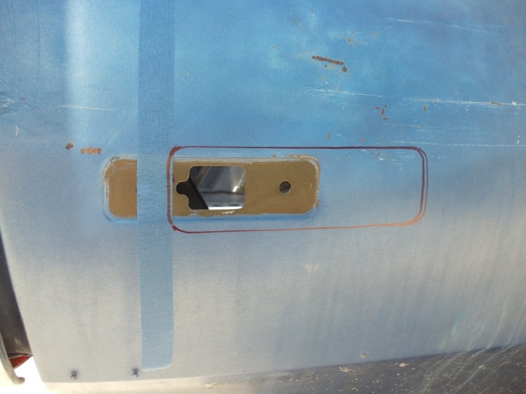

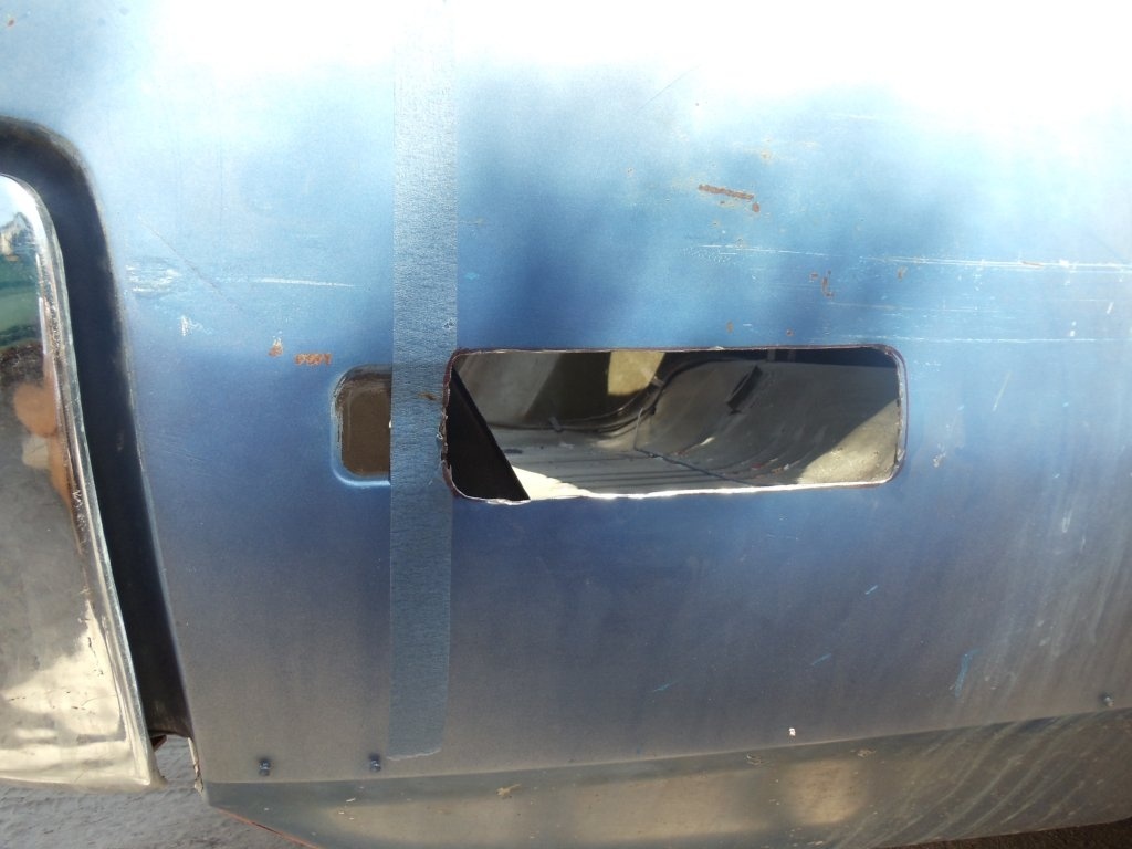

I didn't like the side marker lights on my 72, so I made 1971 templates (stainless steel), cut out the proper hole in the factory sheet metal, and then bonded the templates to the inside. This gave my "new" 71 side markers the proper indentation. The only "problem" is the side marker lights are a little lower on the quarter panel than the original 71 models because the holes for the 72 models were stamped a little lower for some reason.

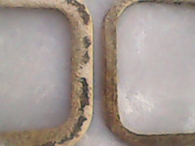

Just one more note, it seems aftermarket foam gaskets for the large off-white plastic inside portion of the side marker lights may be only half as wide as the factory gaskets (but I guess they still work OK).
