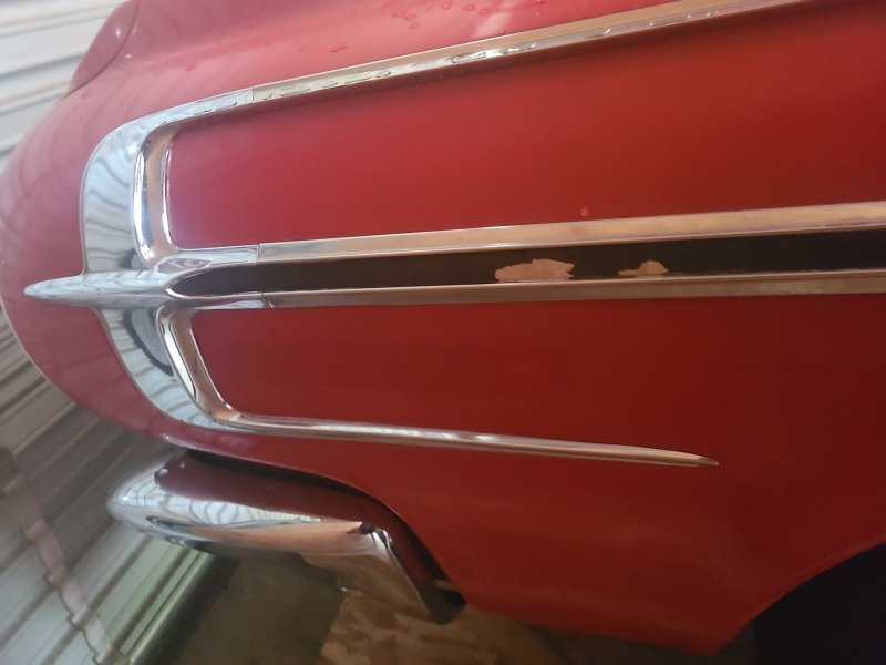

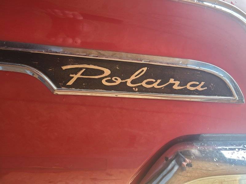

I also have some missing black on the side trim. I ordered the passenger side rear quarter nameplate. The driver side is shown below. My question is, 'Is there an acceptable way of refinishing these parts if I can't find replacements?

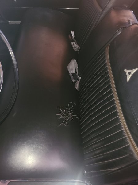

I guess the front seat bottom was replaced at some point with a non-OEM cover, then worn out again. I've found replacement covers at profitautointeriors and Legendary. Is there a go-to sight y'all use or anyone to avoid? Would it be a bad choice to do the front only if I can have the one flaw in the rear seat bottom repaired?

Have painted enough trim and wheels that can be tricky to mask off. When it’s a hassle, I use Vaseline on a q-tip being careful not to get it on areas I want painted. If you do, start over to make sure none of it is left on the areas you want coated. Spray paint and wipe off the vase with a degreasing cleaner after paint has cured, some razor blade removal may be needed. I have some old surgical scalpels I used too. Photo shows example of painting I did using vase, sorry, some winter dust yet to remove.

As for the seat pan, it’s been recovered as you may know, not stock covering. If there’s no splitting, could try using a black dye or marker working it into the cracks to camouflage it. Wipe off any over fill before it dries.

I agree that rubber thing is remains of a ball joint boot. For my side chrome, I used a wide stripe tape. This stays on a lot better than paint

That's an awesome tip. So to be clear would you use the vaseline on the cursive lettering and tape the straight edges of the border?

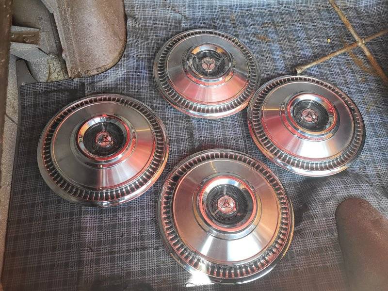

Also, I forgot to post up the original hubcaps I got along with the factory steel wheels. Really nice condition. I'll have to decide if I want to put them back on or go with the Magnum style wheels that are on it. My wife voted for the Magnums so I'll probably go with them.

you can tape off trim and paint the black.
Yeah, if you're meticulous with the masking, it'll turn out good. The bat wings on the Coronet took me about an hour to mask. Good enough for driver-quality.
Great idea, Ron. And my wife just suggested masking fluid. She uses in her crafting world. I guess you can even get it with a needle-type applicator... for tiny, hard-to-reach areas. It dries to a boogery consistency, and you just peel it off when after it dries.
Someone gave me this tip years ago when I was restoring an old set of Magnum 500 wheels and came in handy with all the trim and dash parts I later refurbished. Hobby Lobby is a gold mine for all sorts of detailing stuff I hadn’t seen before such as tiny needle point q-tips that worked nice when restoring the pushbuttons on the dash. Glad I had some mule buttons as anything alcohol on old plastic is bad.
Great info guys! So I can use vaseline, masking fluid or boogers. I have 2 out of the 3 on hand. I do want to refurbish the Magnum 500 wheels also. My push-buttons are also worn and partially unreadable so maybe I can spruce those up too. I have an excellent automotive paint store and use their recommendations but what kind of paint would you use on exterior trim and wheels? They recently mixed me some SEM paint (stain really) to refurbish a console and colorize some new plastic seat skirts and hinge brackets on another convertible. If the results don't satisfy me or starts to fail, I can easily go the vinyl tape route.

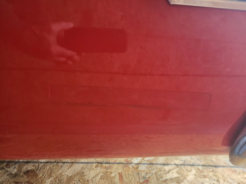

The original owner stuck reflectors on the rear quarters and a 3rd brake light on the trunk lid, then repainted the car around them in a slightly more orange version of the stock red paint. When the car changed hands after his death they were removed. One side still has the original paint showing and the side wnet down to primer-sealer and is a real eyesore. I talked with 2 painters yesterday and came up with various possible remedies from painting the whole car (don't want to spend the $), to painting both quarters and the trunk lid (still expensive), to partial repaint of the quarters and lid (not ideal). It is single stage paint. I've been trying to come up with a solution like putting something like a decal or something there but can't think of anything that would not look totally out of place. Any ideas?
You can just see the location in front of the rear bumper, below the trim. They were about 10 inches long by 2 inches tall.
The trunk. Less noticeable because of location.
