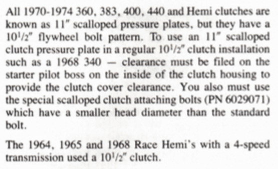

4. There's "something" about a "scalloped" clutch... like it's almost 11" and fits the 10-1/2" clutch bolt pattern (not sure about that)
5. A flywheel that takes BOTH bolt patterns sounds like a good idea to me
When I very recently put mine back together with a "new" engine and tranny, I leaned heavily on advice from folks here AND consultations with Brewer's.
Can't go wrong there. :thumbsup:

I went with brewers aluminum bell and 10.95 scalloped clutch behind 493 charger with custom comp cam solid roller , hemi 18 spline and 8&3/4 with 410 locker and moser 30 splines axles. with custom drive shaft .
