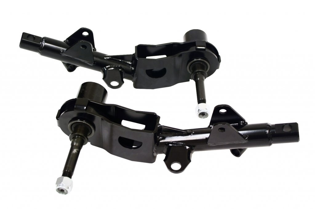

I plan to run the car lower - not sure if I will run 2" dropped spindles. I have heard they are cast and can break, bump steer issues and so on. But this is just what I have read. Others say they work well - so who knows?

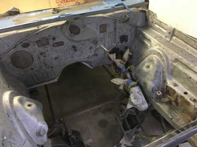

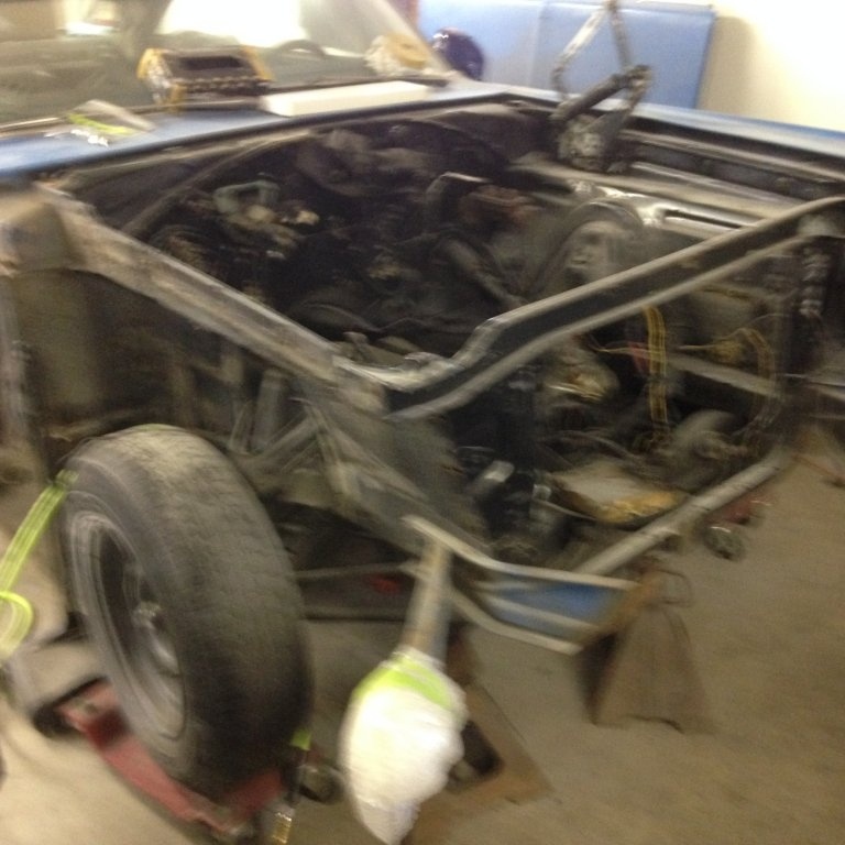

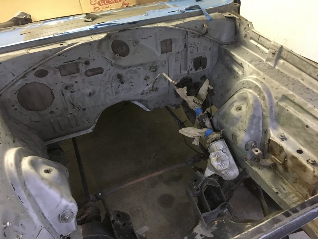

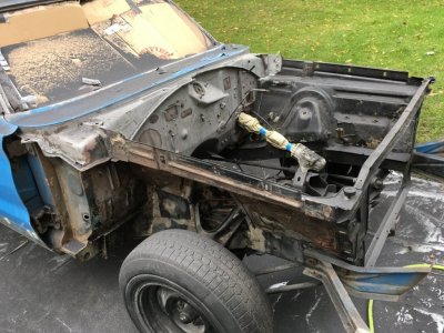

Cool. Look forward to pics. I'll do the same with mine. Hopefully it will be here tomorrow. Right now my wife is loving the extra car in the garage on jack stands. Almost hate to deprive here of the experience by completing it.
lower is pic when we took it home. Stripped fronet end was a few weeks ago. We have done allot of sheet metal work on this car so far - I can post pics if anyone interested. Hopefullly this will be an awesome garage built car when done
