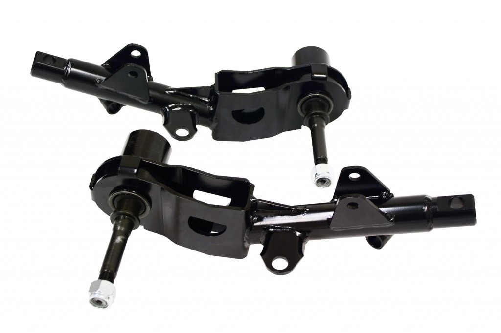

Repost, to put #'s on stuff,
so I didn't have to type it all again
real individual prices, kit form it's cheaper as you see above
Added comments;
I have the Double adj. SPC UCA's instead of the QA1's too,
just my personal preference for on the car adjustabilities
laying back the caster for drag racing {several degrees if need be} or
laying over/in or out the camber for cornering {several degrees if need be}
or ride height to an extent,
I'm a tad bit limited because of using OE style Torsion Bars,
instead of coil-overs
I personally would think about fabbing up some
{Lamb Struts maybe} Struts/w-adj. springs for a serious ride height adjt.,
instead of control arms, front steer rack, if I was to do it all over again...
$240 each SPC
$550 QA1
$220 QA1
$460 QA1
QA1 it's $2200 ballpark,
{$1799 in Stage 3 Handling kit 2/27/2017 not with SPC, it has QA1's UCA's}
that is pretty reasonable, for the front
{if you can't make your own, want bolt on stuff}
it's not anywhere near the $3,500-$5k-$7K, like some can be,
you can still use OE steering boxes or OE/OS Torsion bars
with certain QA1 K Members too,
have them add the tabs for Sway bars on the LCA's
add a aftermarket sway bar $200, in it for about than $2400-$2500
{or less kit form} add what ever shocks etc.
that is a big part of the cost especially if you go Coil over,
prices are all over the map
$300 for Mopar Performance 1" or 0.960" Torsion bars,
cheaper maybe if you shop some
If you stay with the torsion bars {not saying you have to}
but you can go with a cheaper/more affordable shock &
still have great front suspension adjustability
@ an affordable/reasonable price...
In the scheme of things it's downright affordable IMO
