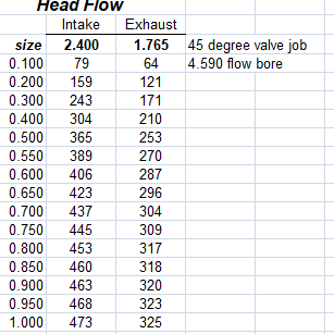

His car is going 9.70s now, I think it's probably pretty well sorted out, at 3600 lbs.There's noticeable power to be had going -1 with a 2.25 valve and if you upgraded the rocker gear to a paired rocker system you could put a big cam in it which would be worth more. Then again how well sorted is the parts combo you currently have?
