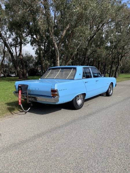

Hi all,
My son and I have a 70 4 door Aussie Valiant that we drag a bit, at the moment we are setting up for our Australian version of your Drag Week, ours is Drag Challenge.
the event will be end of Jan over 5 race days with over 1000 miles of street in it. We last done the event in 2019 and finished 2nd in class just, so looking for a bit more.
The class we run is Small 9" Radial Naturally Aspirated Street registered.
Car is 3650 lb and runs 1.40 60', 110 mph 660' and 9.82 136 mph. 528 wedge, 12.6-1 KB, Molnar crank, 360 cfm indy sr's, 280 108 with about 700 lift solid roller with Huges 1.6 rockers, matched Indy tunnel with 2 new 950 APD carbs.
Gearbox is kitted 727 with a good TCE 5000 convertor, 3.5 gears, it flashes to 5000 rpm off the foot shifting at about 6800 and traps at 7000. All this is fresh.
Can anyone see some improvement to be had ? We Know there is a few guys running in 70's and would love to keep up with them.
Will put pics up next post.
Cheers
