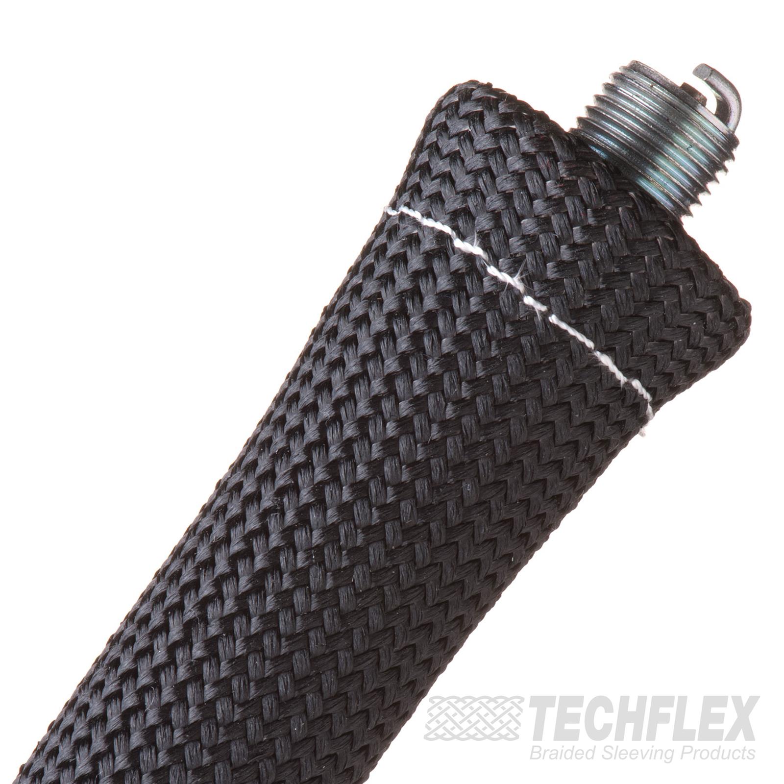

Good shot of them here.
They're the ones that are
7.50 inches long, rated @
1200 deg. They work very
well.
