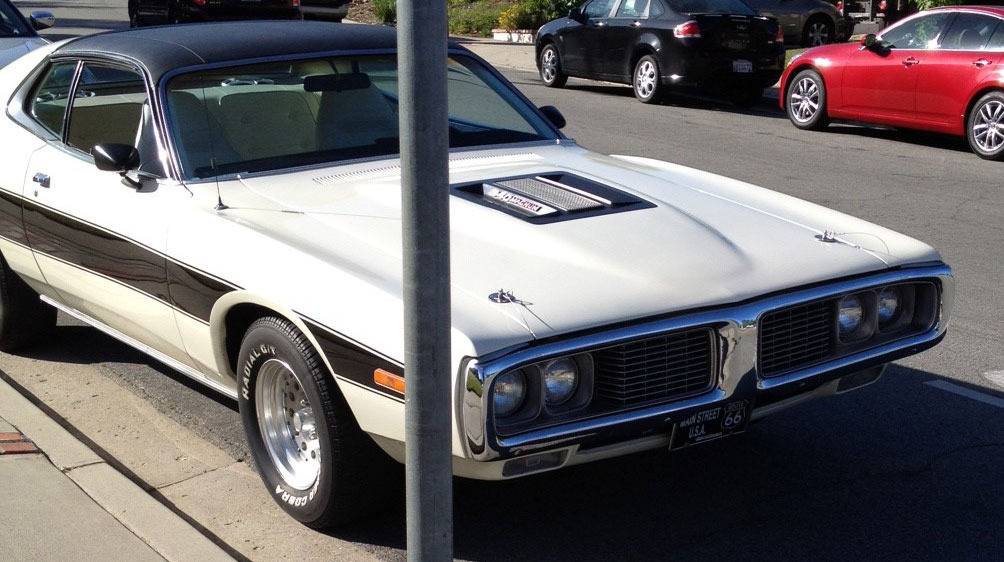

What hood is this?

I hadn't seen this one before... looks really cool. Does it have any functional fresh air system? I imagine not, but still it's pretty neat.
The center section is basically a non-functional plug for the square hole that a functional air grabber setup can use.
Thanks YY1, I see that now. I think I would like that hood either way
71 only.
Air grabber option, or standard for Bee, that simulated vent with engine size call-outs, and for the R/T, louvers.
72-74 Rallye cars got a hood with the same bulge but no square hole for any of the three options listed above.
All are expensive, and very rust prone for some reason.
Much more so than flat hoods.

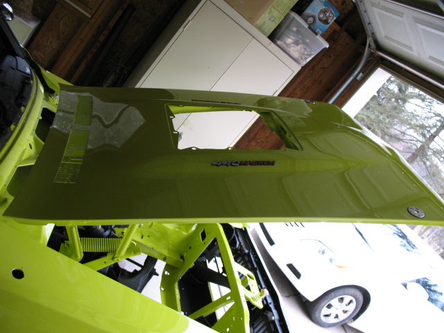

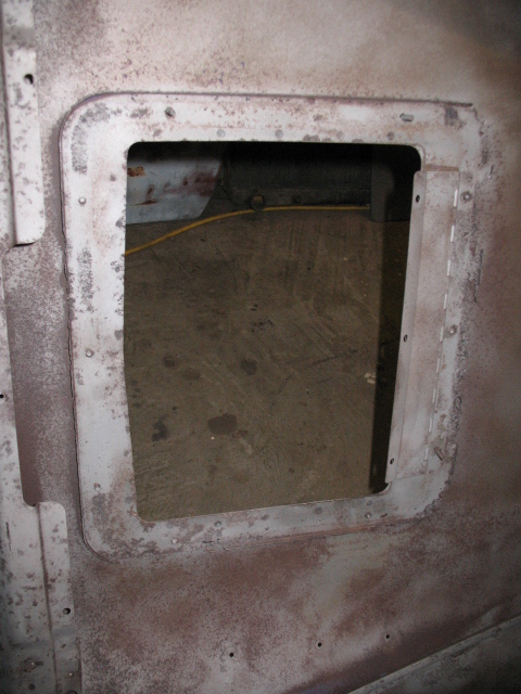

The hole on the air grabber is smaller then the hole for the louvers and call out insert.
Agreed, The pop-up vent door is much smaller then the inserts and is a different shape.

Wow, another one of those..."why would they go to the time and expense to tool two different parts"... examples.
Looks like with a little work that you would never see, it could adapt either way,
The fiberglass ones I researchd have interchangeable center section parts.
