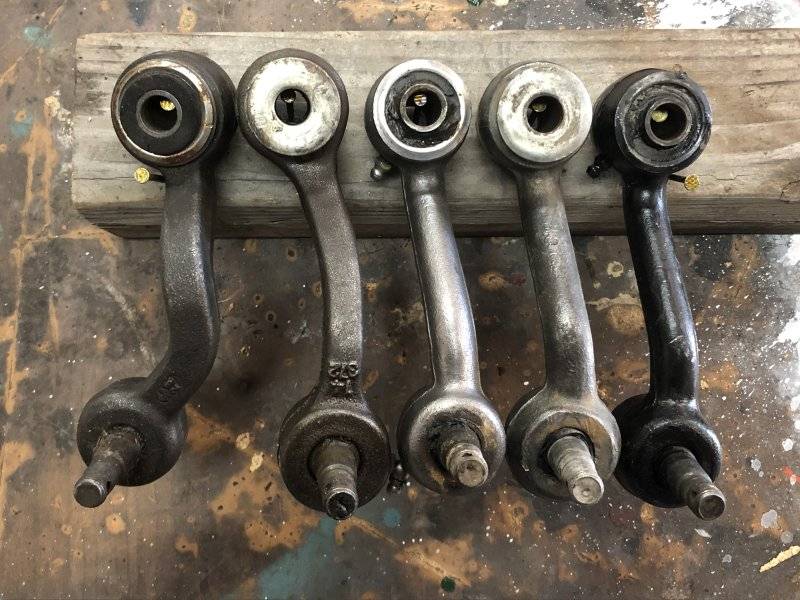

A small sample of the Idlers I have that seem to fit the 73-76 A body and the 70-72 B as well as a 70-74 E body:

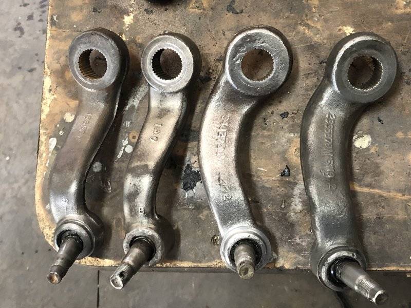

A few small sector Pitman arms. Fast Ratio on the far right end.
I've tried to run an E-body/70-72 B-body idler on a 73-76 A-body K-frame and the centerlink was not flat. I had the E/B-body idler laying around, and the idler "looked" close... but it wasn't. An alignment guy spotted that.
I had to correct that by running the correct 73-76 A-body idler arm. Then the centerlink was flat.
***The idler arm to centerline joint only swivels laterally. It's not a true ball joint like the pitman end. So if the centerlink is not flat it binds the idler joint and will cause premature wear. I drove 1600 miles across country and a few months before figuring it out. So it's not like the car will suddenly explode and kill you. But it's not right.
