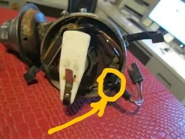

I have seen several instances where the reluctor wiring shorts to ground . For example, the reluctor wiring shorted to the distributor case (grommet worn through and wire shorted out). Also, maybe one case of an electrical open at the reluctor inside the distributor.

The reluctor did show wear like it rubbed something at one point, but gap was correct.
