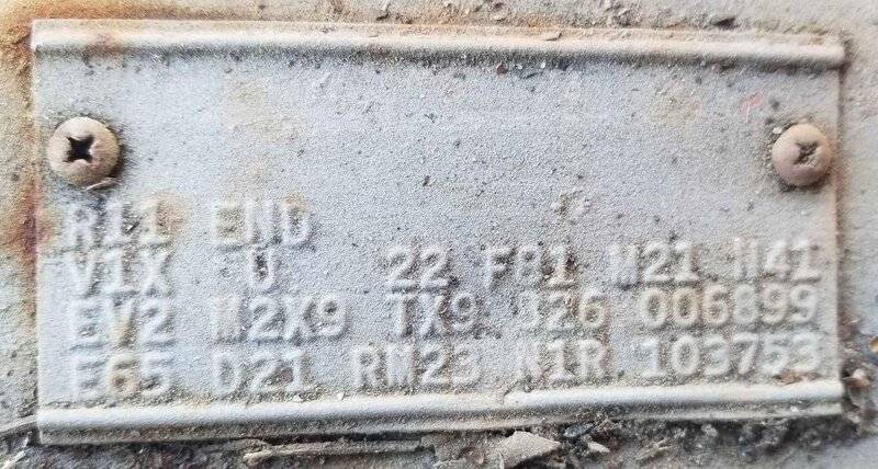

What is F81 on this fender tag?
A brief list, but interesting.:)
NOT MINE
The Galen White book does list it as a "Deck release remote" whatever that means.
That fender tag is on a car I found for sale. It's not mine.
Do you have a push button inside the glove box?
I have a push button inside of the glove box on my Super Bee. You push it and the trunk lid releases.
I have it disconnected from power. There is an electric release mechanism inside the trunk. I tend to think it is a mid to late 70s vintage mechanism that a previous owner installed on my car.
Apparently there was a factory remote trunk release option for the 71 models. I just don’t think mine is factory..
I believe C body could have it. I have a vacuum operated one from a 72 Fury. Has for a 71 RR, I don't think so.
