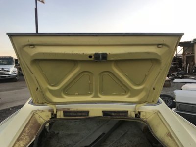

When you open the trunk, there are two rubber flaps designed for fresh air movement

This picture is not mine but shows the flaps. they are available as repops if you need them
