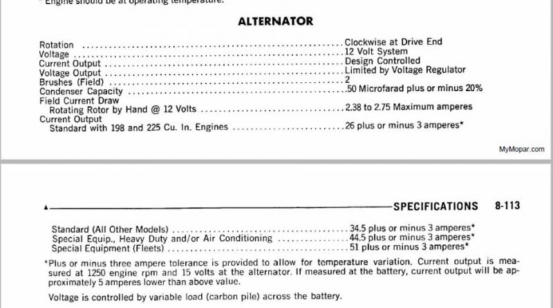

From the 1970 Factory service manual:
Nice! So per FSM, Mopar alts make their job over 1200 RPM! Late for the terminals at bulkhead.
