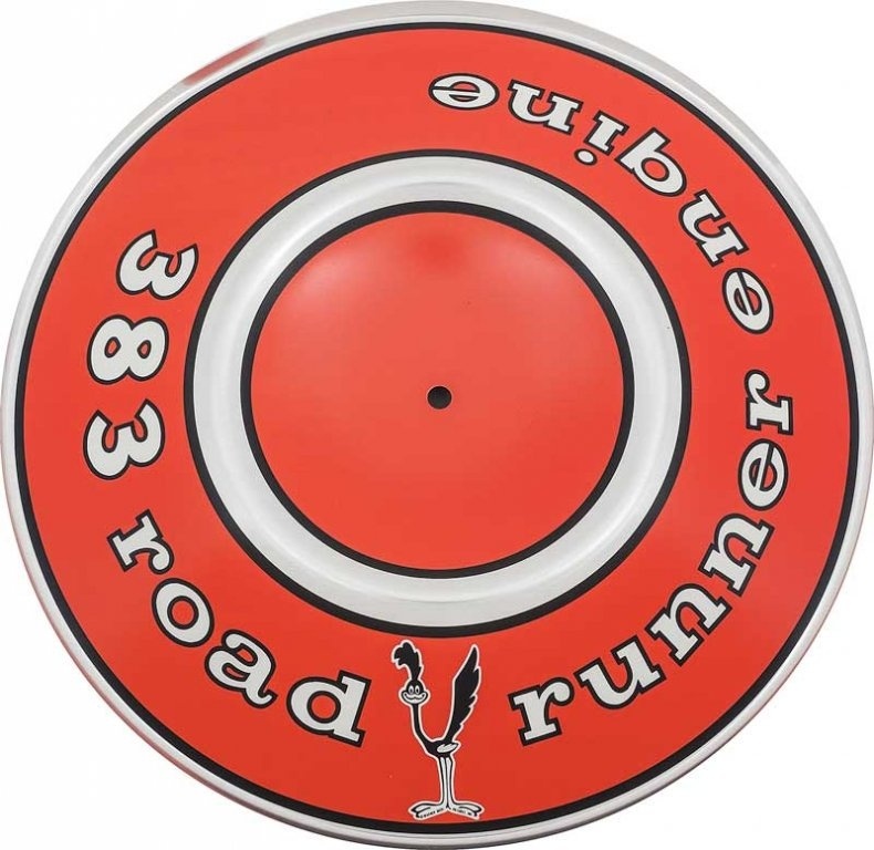

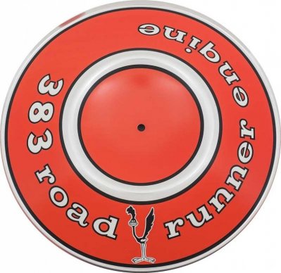

Question for the experts...Did the 1968 Road Runner 383 come with a "383 Super Commando" Tin on the air cleaner...Or was it the "383 Road Runner Engine" ???
Thanks !!!
Here you go....
I have the 383 Super Commando on mine right now...Time to make it right !!!
