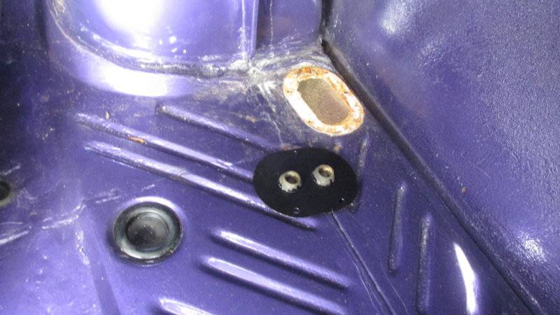

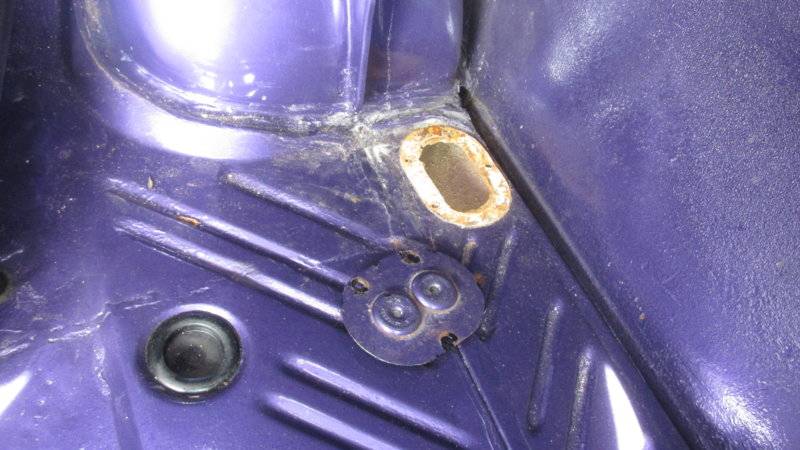

I have a 1970 Dodge Coronet R/T, and it's my first Mopar. I'm working on the rust in the trunk, and was wondering if one of you Mopar experts can tell me what this part is called; I attached two photos. This part is located on the passenger side on the trunk floor pan behind the right wheel housing. Also, can anyone tell me where this part is located in the "1970-71 Chrysler Passenger Car Parts Catalogs , Volume 1,2, or3"? thanks, Richard

Is there any metal lines connected to it ?
It is the gas tank vent but the lines are missing. They go through the 2 rubber grommets. It is a loop inside the trunk. It comes out tank, into trunk, goes up, turns back down and out the other grommet.
Thanks, is there a diagram anywhere that I could use to get it back to stock. The car is pretty much as it came from the factory.
