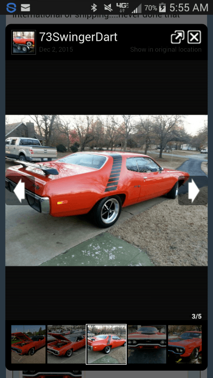

That is a member's old car I believe
Black trim going across the roof with studs. The studs has plastic clips that retain the trim to the roof. Two holes, one on each side near the 1/4 glass that holds the ends of the trim to the roof. On the end of the trim, you have a metal clip with a nut on it. The nut is accessed under the headliner.So with a half vinyl top, is there a strip of trim across the roof...and does that mean there are extra holes in the roof to hold that trim in place? I don't think I've ever seen one in person...so just asking.![]()
