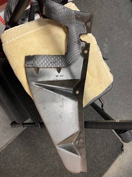

Tape fell off this part I took off my 70 Roadrunner 3 years ago. Anybody know what this is and where it goes?
Yes. It mounts to the drivers side frame rail and serves as a splash guard for the starter. The U shaped cutout allows clearance for the steering linkage.

Anybody have an idea where you can get the shield? I have the rubber piece and the staples already.
I just looked around and see that the shield is now reproduced. But a few sites say that this is ONLY for auto trans including AMD which I believe made the tooling. Question is if there is a separate part for manual trans or if the manual trans ever had one. Any idea?
Thanks.
Thanks.

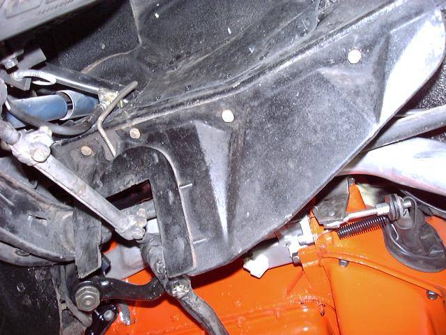

Negative on the manual trans. Only automatics got them to my knowledge.
Thanks! I looked on the frame rail using the attached picture to see if there were holes on the left side. There are, but doesn't look like they have ever had a screw in them. I suppose the holes were there whether it was an auto or manual trans.
