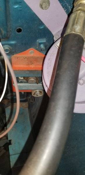

Hey so I am rewiring my Car and some of the things just don't add up. This is on the passenger side of the Car. The distributor has a wire going to this orange box and then a wire going back from the orange box to the ignition coil.
American Auto wire requires you to have a one wire Alternator. It also has the distributor sending one black wire to the Ignition coil. Problem is that the distributor I have has two wires coming out of it one black and one gray and they go straight to this orange box mounted next to the radiator underneath the horn. This orange has four plugs coming out I am making assumptions but I know one is going to the Ignition coil, the ballast resistor and then back to the bulkhead connector.
Basically I am asking what is this... if I can by pass I can hook the black wire from the Distributor to the IGN coil but what about the grey wire. Reading the schematics it looks like it has something to do with the alternator.

that's the electronic ignition module.
somebody added it if your car is a 69??

which means the distributor has probably been swapped and some other stuff added or deleted. if you don't have much experience with this stuff I highly recommend you get someone who does.

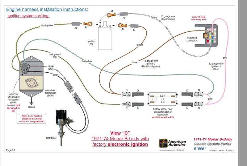

I did the American Auto Wire on my car.. You need the Orange box, unless you go to a new a plug and play distributor. Also, yes you must have a 1 wire Alternator.
Here is how you need to wire the Orange box. You can buy just a harness if you no longer have the black plug that goes into the Orange box.

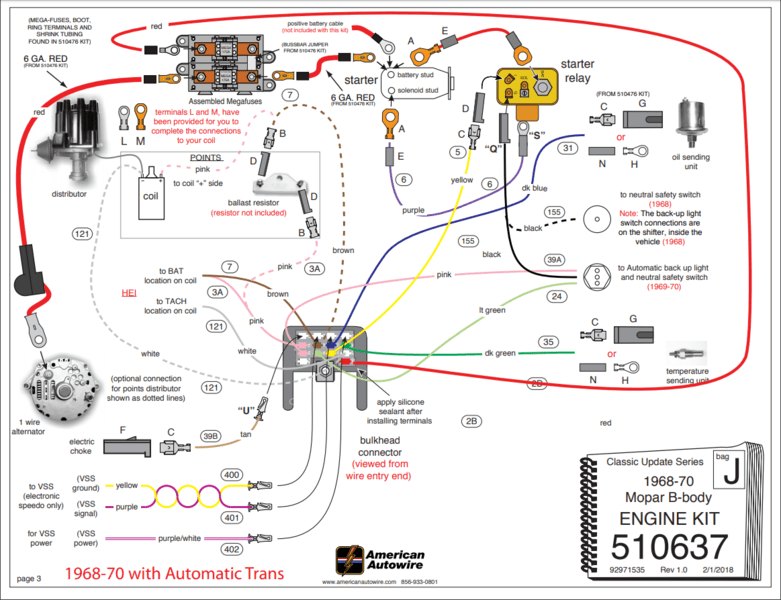

OP, you seem to be mixing ignition wiring (orange box) with the charging system wiring (alt & voltage regulator) they are separate but voltage reg & alt field need the correct voltage source. Wire the orange box per the Mopar wiring diagram & alt per it's diagram.
Good god could they make a more confusing wiring diagram?
Yes i was using that..... that is why i was F%$%ing confused as hell. Derwud helped me out a lot. I got it figured now.. about to buy a one-wire alternator next.

Not entirely true....the ballast resistor limits the current the orange ignition box handles and reduces the voltage to the coil during the RUN MODE. The resistor is by-passed (allowing 12 volts to the coil's primary) during starting to insure a "hot" (full voltage) spark for easier starting.
The original ballast resistor (points distributor system) was approximately 0.5 ohms. With the Mopar electronic distributor system (presumably this is what you have) the ballast resistor is approximately 0.1 ohms but is bypassed during starting. Just be careful in what coil you choose....if incorrect, it can damage the orange box module by asking it to switch too much current (the transistor on the outside of the case does the switching of the coil current).
My opinion.....you DO NOT NEED a one wire alternator just use what Mopar designed and installed with the original alternator and regulator. Consider using an electronic regulator in lieu of the origional regulator with your existing alternator. I'm sure the MSD ignition system proponents will argue why their way is best. Are you going to race the car or just looking for reliability? If you are going to car shows what you have/need will be just fine. Just my opinion of course.
