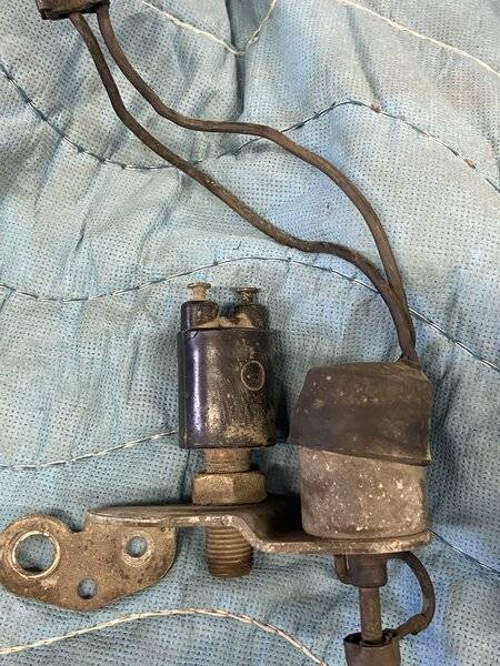

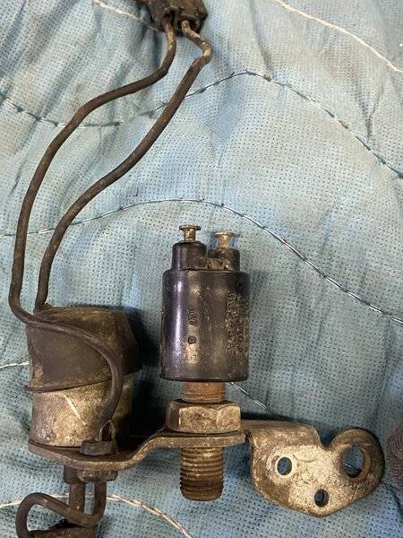

What is this part?

Not sure but possibly an idle kick up for when air conditioning is used or when engine is cold ??
Thats what it look's like to me. Somebody in the know will chime in Im sure
It's a first Generation flux capacitor, sorry, couldn't resist. IDK what that is, watching for education. Good Luck
Looks like an idle control to me.....seems like I remember seeing them come out around 70 or so on the bigger cars....?
It looks to be a proximity switch that actuates a solenoid.
It's not something I've seen on any pre 76 Mopar.
1977 Lean burn transducer and idle contact switch from a 400 or 440 .

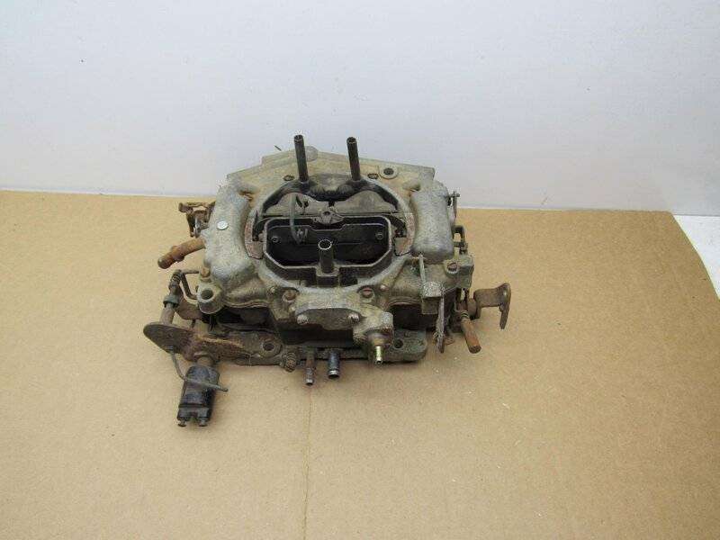

Yes this man is right so listen to him. That lean Burn transducer from what I remember was like a TPS on that lean burn system. Lean Burn was an early type of feedback carb system and I believe that transducer told the controller the throttle position and when at idle. Its been many years for me as I dont remember if it was an actual potentiometer or just told the controller when at idle and off idle on the gas ? Being I think they were just two wires I dont believe they were an actual potentiometer like a TPS ? Ron
