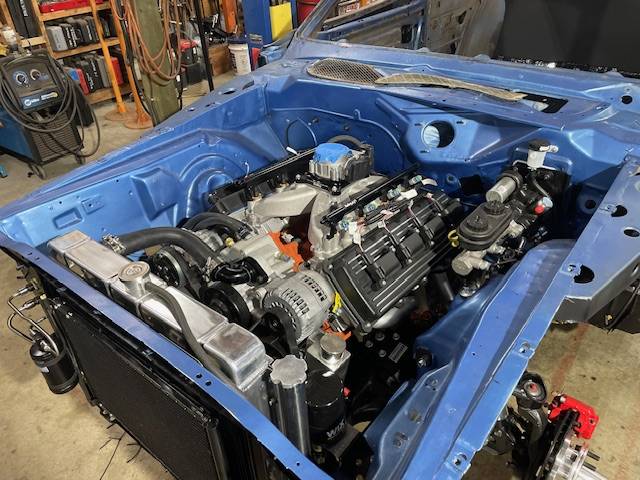

I am using a Holley Terminator X (Max), mid plate, intake, 4150 adapter, and oil pan. I don't have the can running yet but I can say that everything fits and seems to work as expected. I really like the mid plate, although not cheap is really well thought out.
Midplate? Car looks fantastic. Detail is phenomenal
Oh, ok. Midmount accessory drive, not a midplate. Midplates go between the engine and transmission and act as a rear mounting point for cars that have a front engine mount plate. Race car stuff, threw me off but thanks for clarifying and I love your car.
Yeah sorry about that, brain fart..
