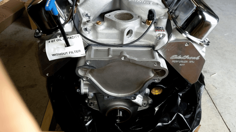

Here it is - the engine I chose.....
https://blueprintengines.com/products/chrysler-408-dressed-fuel-injection

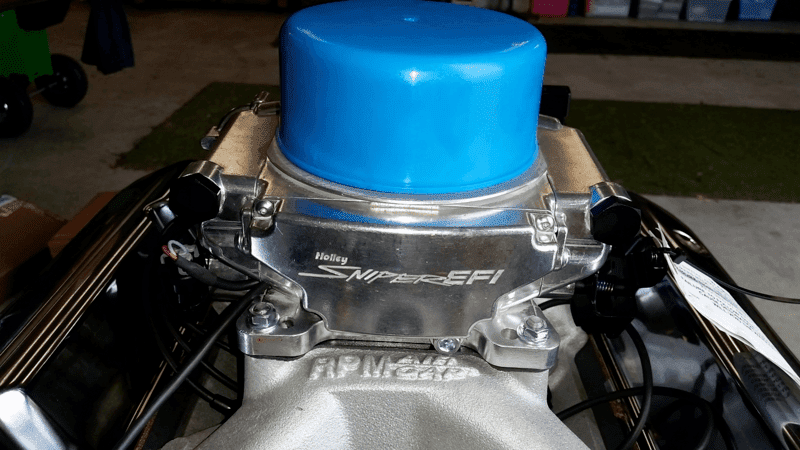

The type of EFI changed just before I purchased, so I am now the proud owner of a Holley Sniper system. Man it is way better than any carb system I have ever had. Once you get to understand how these work, there is no way you could ever go back. My buddy Cliff is so impressed, he is looking at putting a Sniper in his Ram.
Choosing the 408 was a no-brainer really, as it slots straight into where my 360 was, and the original mounts and brackets, transmission...everything just bolts back up together.

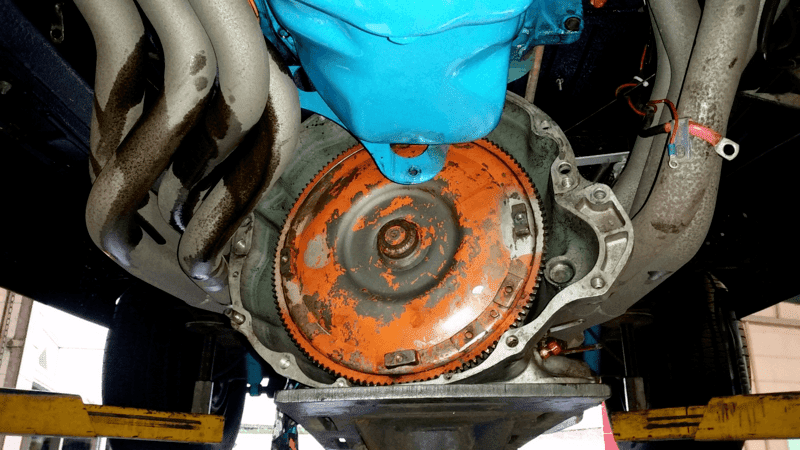

Started the project back on 4th of June this year....by removing the engine and transmission for inspection.

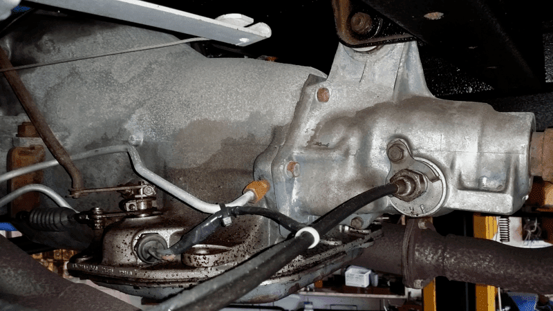

The engine looked OK inside, and will eventually make it's way into my buddy Cliff's truck. Transmission was taken straight to a local specialist who has a passion for MoPar work. Tony gets so much Jappa junk and odd-ball transmissions, that this was a dream job for him. Started by tearing it down and cleaning all the parts. Installed a street shift - I opted to go small, as it's hard to wind the clock back once you go big. :D Also installed a slow bleed valve from the torque converter - meaning the fluid doesn't bleed out within hours or days....since the truck might sit for longer periods than normal. Replaced the neutral back-up switch while we were there. I had a local Engineer repair the damaged holes for the dust cover and two mounting holes as well. The welds and re-threading is so good, it's hard to tell it was done. :)

Transmission valve body lever was badly worn , so a call out for help netted a good used unit from '65 Dartman' at FABO. Thanks for helping out Don...much appreciated. Once that part was worked into the mix, the trans was completed and ready for installation.
Before.....
A new neutral safety/backup switch was installed along with a new loom to the relay - actually one from a 1970 Plymouth B-Body :D ....who said it couldn't be used for something else. :steering:

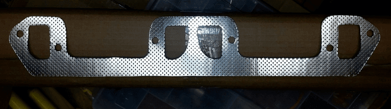

Which led to the next issue - gaskets. Some of you may remember me asking what gaskets you guys used. Well, turns out there were a lot of great suggestions. When I made inquiries locally, I was pointed towards a Custom Gasket facility just down the road from a fellow FBBO member - @Chargerjase . I marked up a set of new TTI gaskets for the Edelbrock heads, and sent them down by urgent courier. The guy had the new gaskets made and repackaged on the Courier the same day he received them. Now that is service!!! The place is called gaskets BOP Ltd - https://www.gasketsbop.com/ - a small family run business that is hot on service.
The gaskets are double steel outer (both sides) and soft heat resistant material inside. Simply fit dry and tighten up on the manifolds or headers. I swapped out the old header bolts for studs with star washers and quality nuts. So far all sounds great...no leaks.
Template marked up...
The new gaskets...
Getting them made locally was still cheaper and faster than buying something exotic from overseas. :)

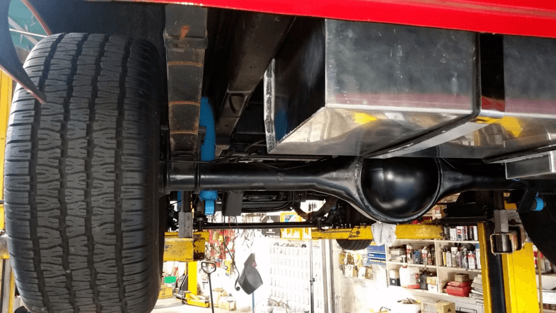

While the transmission was being rebuilt and toughened up, I sent the rear end 8-3/4 head for a rebuild and a gear ratio swap-out. The previously fitted 2.76:1 ratio was replaced with a 4.10:1 ratio and Sure-Grip unit. Fresh gear oil was then installed along with a new gasket. Brakes were still in great condition, thanks mainly to the diligent work years ago by our very own Dr Phil - a brake specialist here.
Now was about the time also when the driveshaft was checked over and swapped out for the spare with a bigger yoke for the 4:10 gear set. I have two driveshafts to cover whichever head I'm running. Took a while to source a spare, and I ain't letting either one go. :)

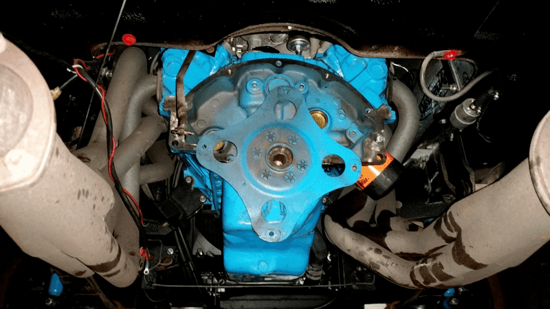

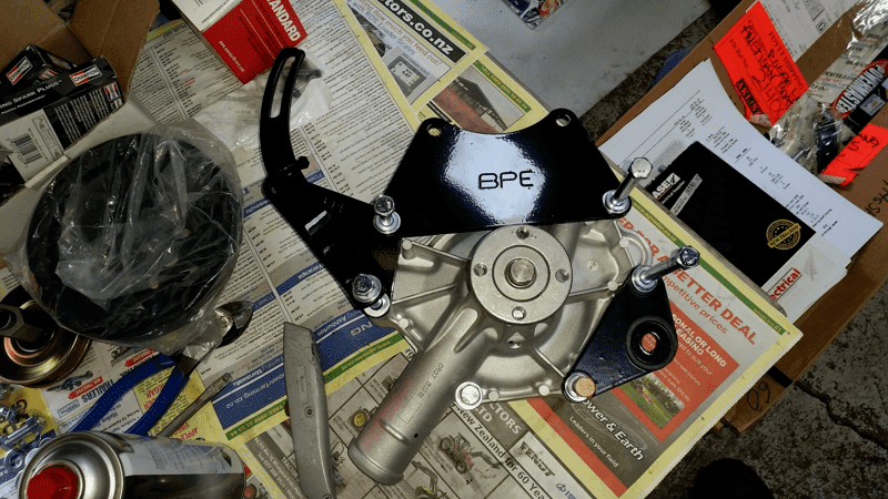

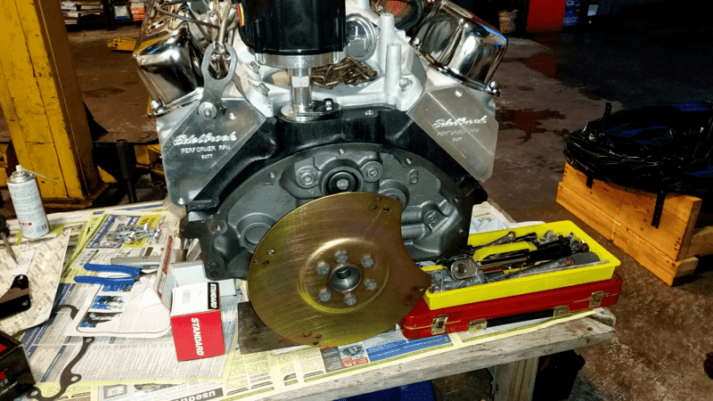

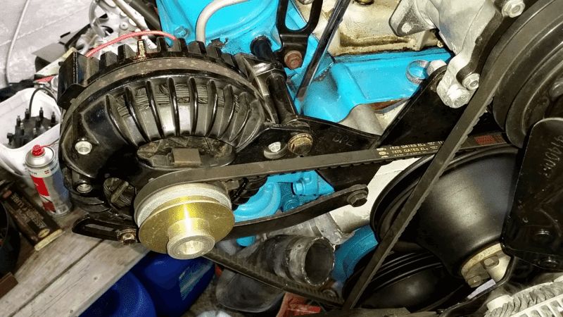

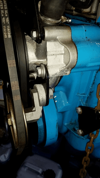

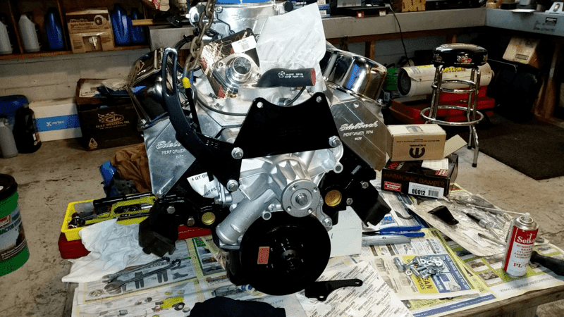

Now that the engine was out, we could start to line up all the new brackets and pulleys for the new engine.
Someone call for a Taxi....2 mile journey to the workshop where the operating theater is located...

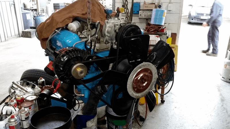

Time to start hanging all the new goodies on the new engine....
Mock-up time now....
Bouchillon performance eventually contacted me, and everything is great - very nice product and a fair price. You can't make this stuff yourself without a lot of aggravation.
Very pleased with their products. :thumbsup: upload_2018-9-20_22-25-43.png

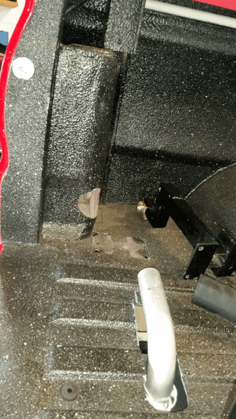

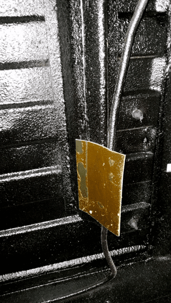

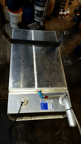

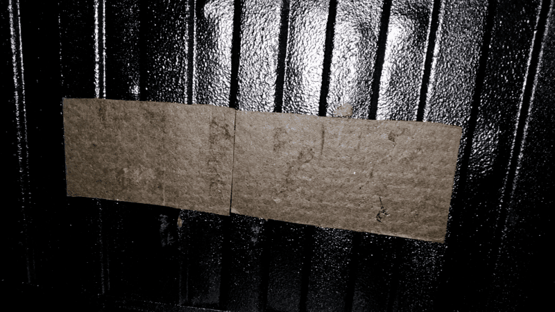

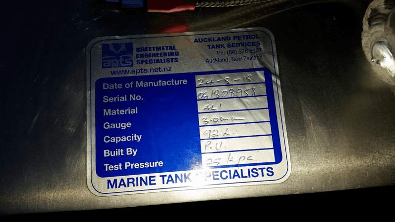

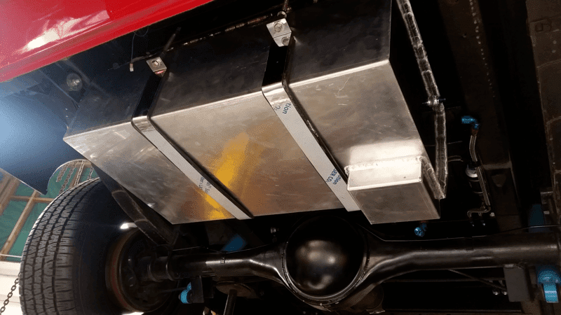

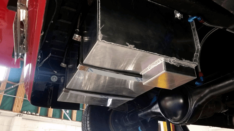

Next item on the agenda is the fuel system. Starting with the tank, it needed work to bring up to EFI specifications. After exploring the options, of which there were few, it was decided that a new custom tank would be needed. Given the time frame and shipping costs, I found a local specialist engineering company who manufacture custom tanks for boats and Hot Rods etc. So I gave them some dimensions to work to, and the old tank as a reference, and gave them a time-frame to complete. Only 4 days over budget, but it was a great looking job that they made. New capacity is 92 litres....approx 24 US Gallons. Complete with internal baffles and a BSP fitting for a VDO sender unit, the tank has a Return fitting, Supply and a drain also. The guys also made some stainless straps for securing the tank in place. A bit of fiddling around with the truck bed floor, and the tank was fitting nicely. Utilised the original J-Bolts also with the aid of threaded sockets to allow a bolt to be the tightening medium. The only part missing was a fuel gauge to match my choice of sender unit - a quick order into Summit got me a replacement gauge. Took a couple of hours to complete the swap-out.
Old tank setup as was previously fitted...
Problem was the level of fill vs the filler tube entry...awkward and slow. Also a little ugly....
Floor exposed underneath...
The new tank almost completed in place.....

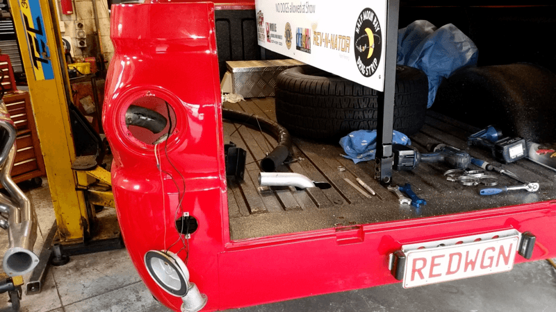

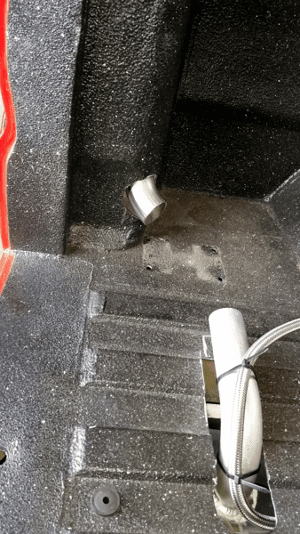

Filler tube and alterations inside the rear quarter was next to make the tank work better. Filling was always an adventure...very slow because of the uphill tube into the tank. Our expert exhaust fitter called in to help out here again...
The old filler tube - done in a hurry 10 years ago..
Time to mock up the entry ....
Dr Phil in action...
Getting tricky to put all the parts together and hidden...
Certification label - these guys are actually about 2 miles from my home....
Breather cap in place....(old fittings welded up and made safe)

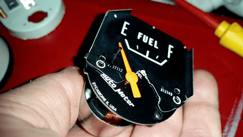

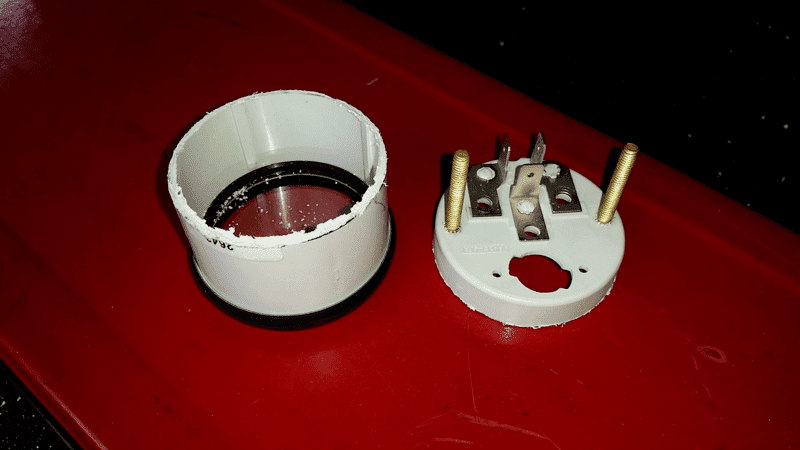

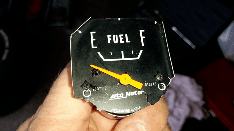

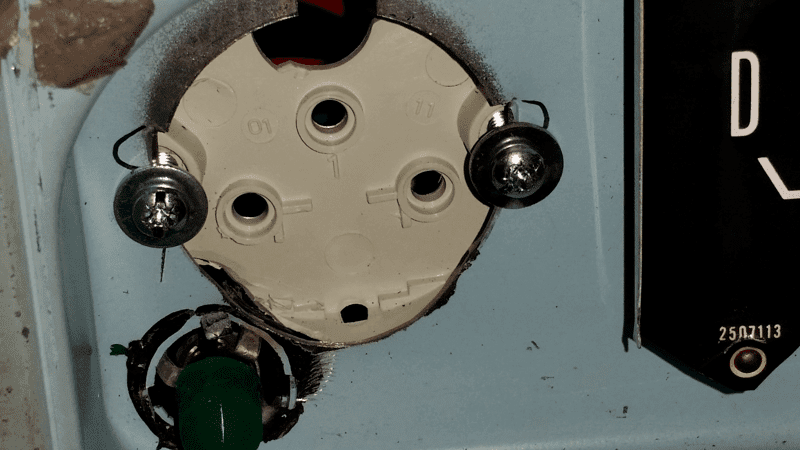

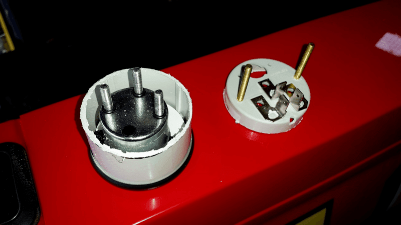

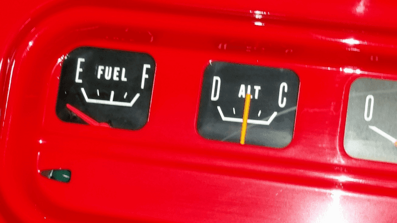

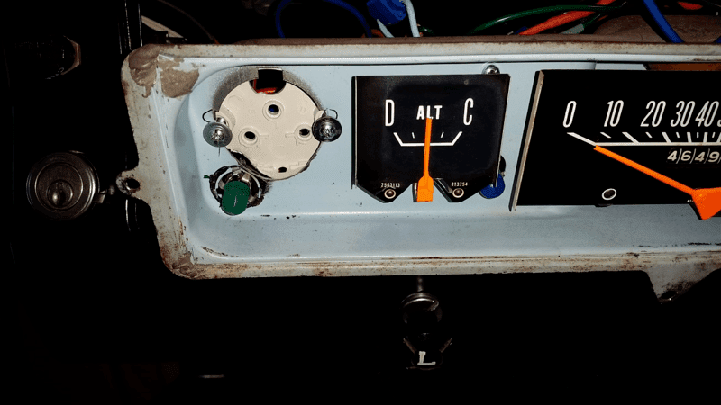

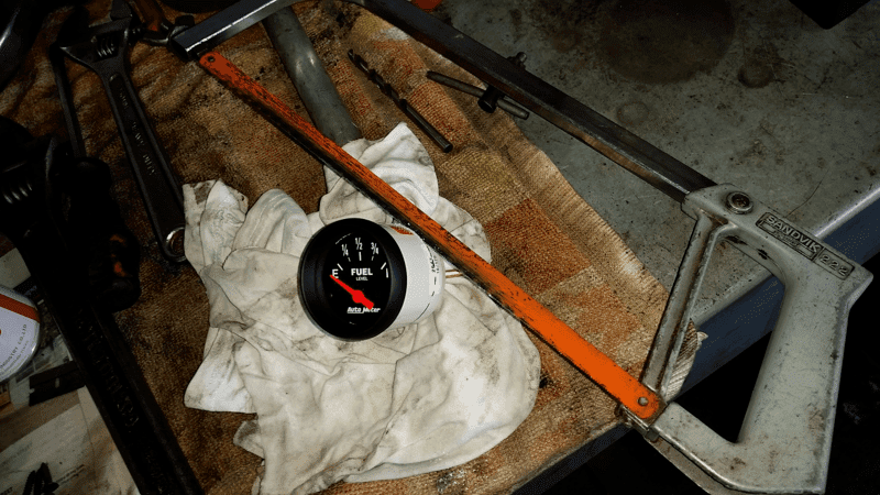

I had already converted the original dash and gauge to an Autometer branded gauge - it was the closest size and depth to fit behind the glass etc....you could say it was a no-brainer using Autometer. Recently swapped out the stock fuel sender unit and tank, so the new gauge had a different range and required the dash mods. Simple, I just bought the correct range for the sender.
Mainly for the benefit of @FU64RY and @69a100 ...but others could find some use here.... :D
Start with a little dissection...hacksaw time...
The gauge needs cutting open to get the internal parts out....

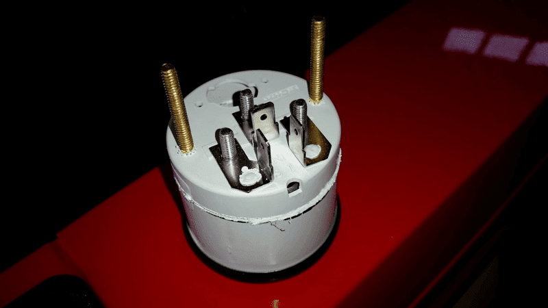

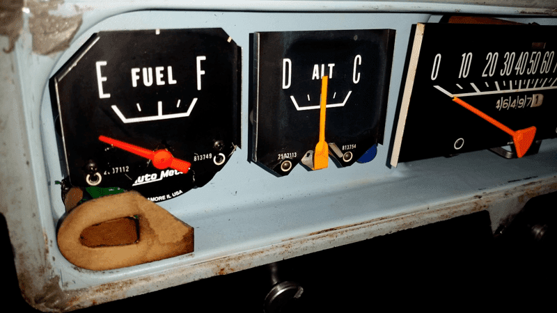

A small mod to the original gauge - this was done 9 years ago....
Mounting studs replaced with nuts & bolts...
fuel gauge swap-out continued....
Be very careful with the cardboard tube surrounding the turn-signal lamp...
