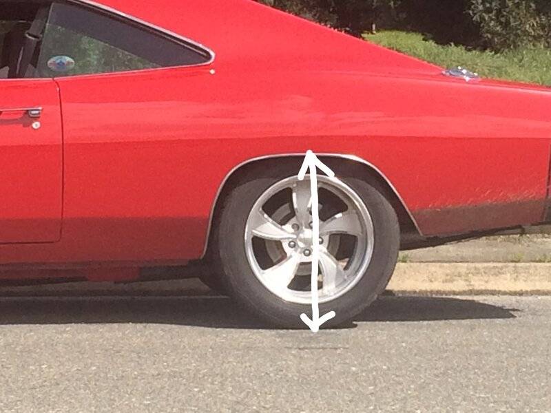

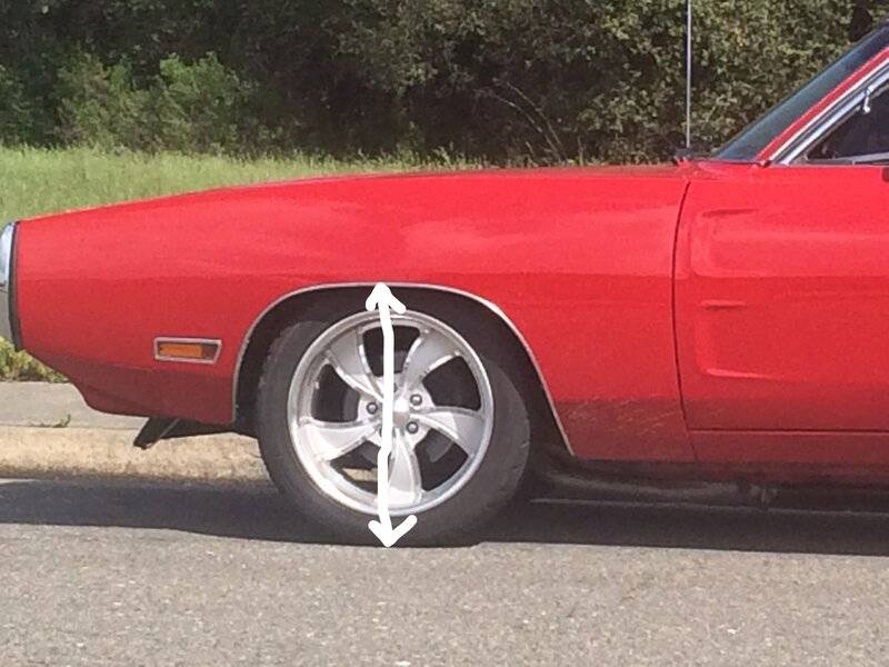

I know that there is a factory spec for measuring this but for many years, I have just measured from the pavement to the middle of the wheel opening arch like so:
Mine measures 24" in the front.....
....And 26" in the rear.
The front is just barely on the bumpstops. I have 1.15" torsion bars and Bilstein shocks.
The leaf springs are Mopar Performance 440-4 speed/Hemi units and I have 1 inch lowering blocks.
What numbers do you have with your 68-70 Charger?
It can be hard to get it even from side to side. Somehow I got lucky. Mine is within 1/8" front and rear.

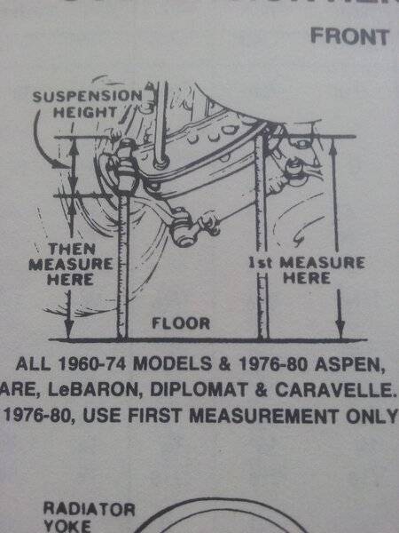

The proper way is to measure from below the car. fenders aren't always square with the uni-body chassis.

I just gave anybody that wants to know how to properly set ride height how to do it..

Well your right. The factory never meant alignment techs to do alignments on their backs on the ground. They used a rack where you can see the whole front suspension.

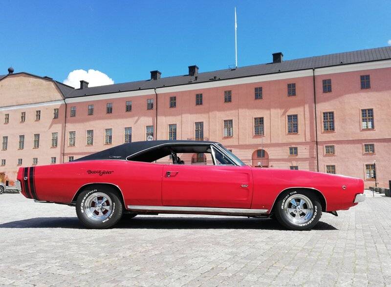

67cm rear, 62cm front.
275/60/15 rear
245/60/15 front
Original HD leafs from eaton.
0.96 torsion bars.
Edelbrock ias shocks.
hotchkis upper Arms, struts and sways.
Alignment set as a modern car.
Such a breeze to drive.

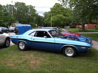

My Challenger has -1" Split mono leafs and Caltracs
