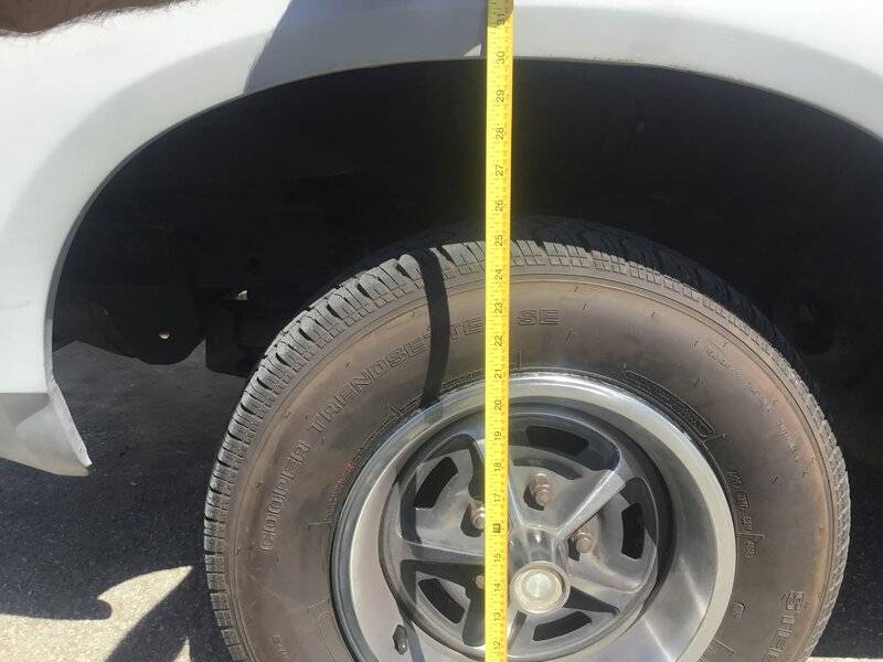

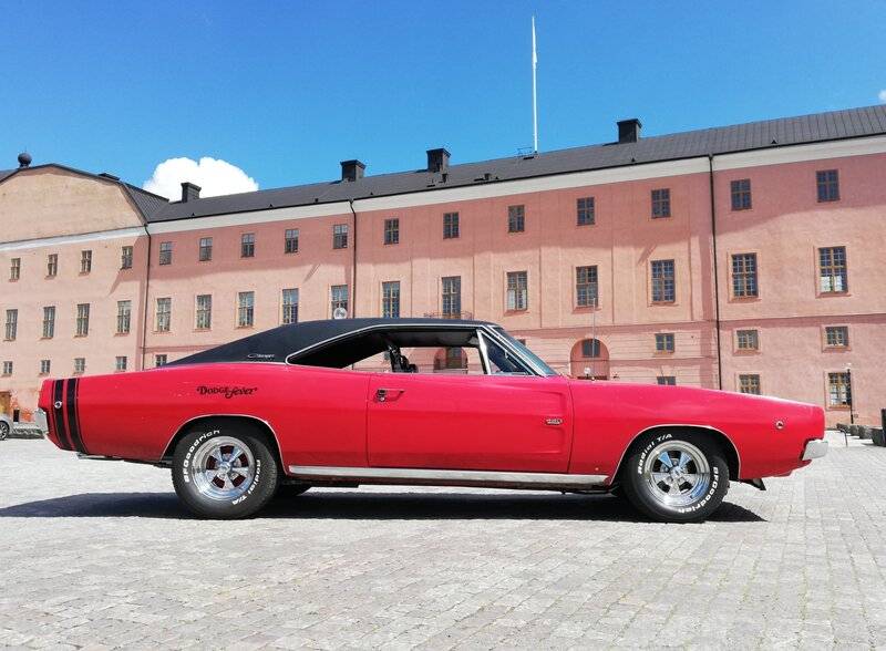

What is your ride height?
67cm rear, 62cm front.
275/60/15 rear
245/60/15 front
Original HD leafs from eaton.
0.96 torsion bars.
Edelbrock ias shocks.
hotchkis upper Arms, struts and sways.
Alignment set as a modern car.
Such a breeze to drive.
My metric chart is broken.
I did look it up online. It seems we are close in height though.
Thank you.

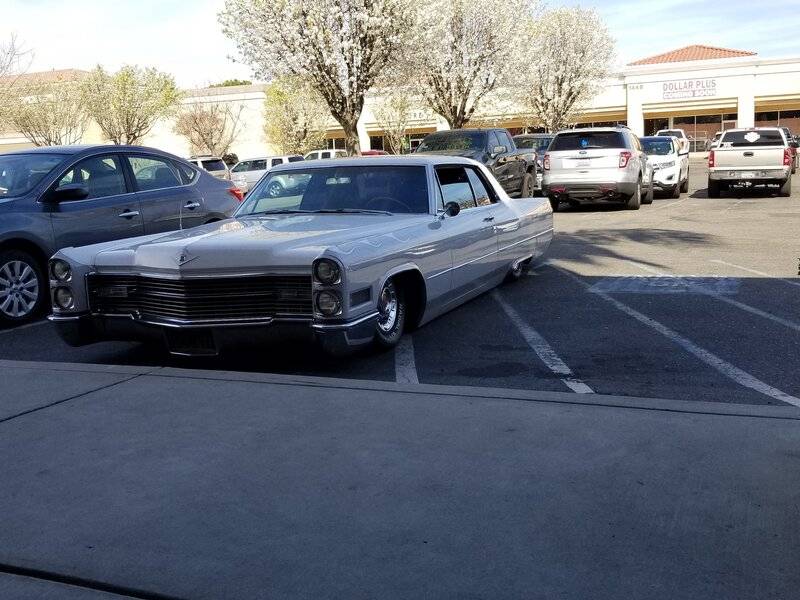

If the car doesn't drag or scrape....and the ride is acceptable, who is to say that a man's car is too low? The law in CA is that no part of the undercarriage can be below the lowest part of the wheel rim. This is not a problem.
Those don't look like CA license plates in that lot.
That was last weekend at the local breakfast cafe....yes they're CA plates. Of course we have about 237 different styles to choose from nowadays (for an extra fee, of course:rolleyes:). The 'Caddy has the old school black w/yellow characters (on the rear only, another "violation":p:p:p)
Obviously going for looks. Wat too low to drive on a street with any dips. Headers are almost on the ground.

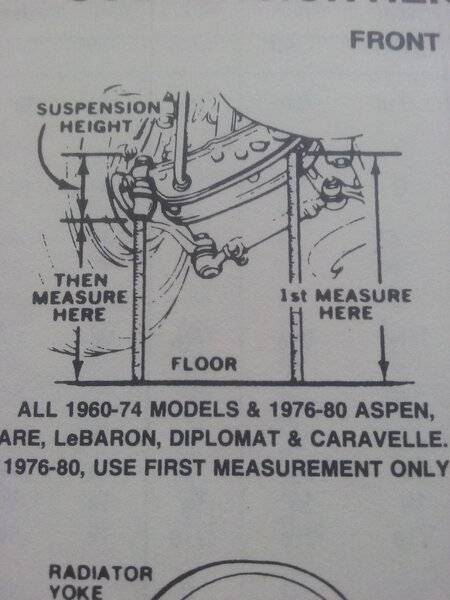

The proper way is to measure from below the car. fenders aren't always square with the uni-body chassis.
He is absolutely, positively correct. How many people here have actually DONE wheel alignments ? If you brought your car into my garage & I did a suspension alignment by using a yardstick from the ground to a fender, I'd be more qualified to clean toilets.

Exactly. There's a DIFFERENCE in adjusting ride height for "suspension alignment" and "visual appearance". Next time someone takes their car in for an alignment, any car, tell the tech just use a ruler to the headlights and fender lips.
There's a DIFFERENCE in adjusting ride height for "suspension alignment" and "visual appearance". Next time you take your car in for an alignment, any car, tell the tech just use a ruler to the headlights and fender lips.

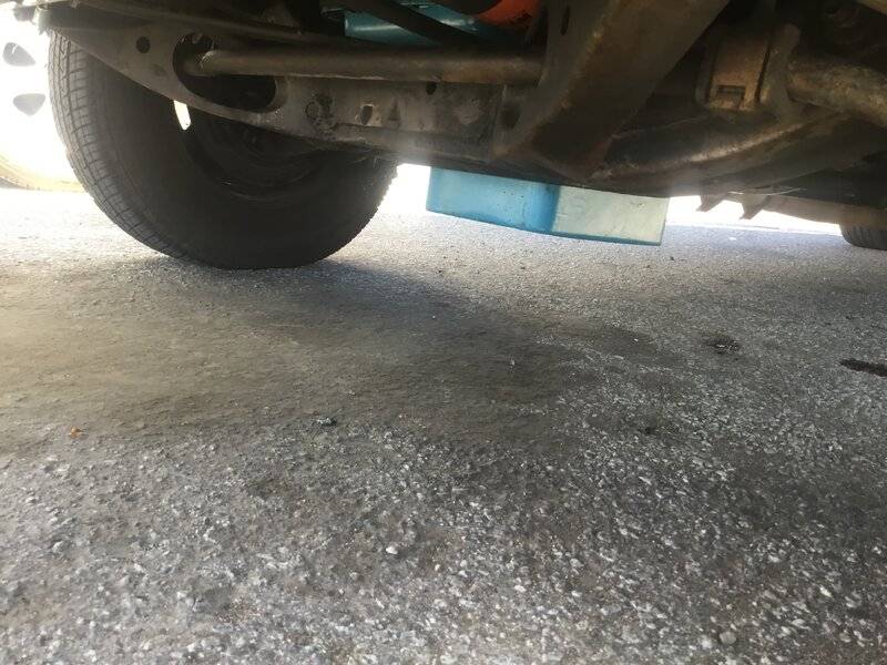

Factory ride heights are set with factory springs, shocks, tire and wheel diameters,
and powertains. Measuring to a fender lip
won't tell the true story. The lowest point
of the frame to ground is ride height.
Note the PVC tubes in place of springs
in this pic....
The ride height was pre determined for
this build.

Don't have to get bitchy, Kern. My reply was to Leo, NOT YOU. Anyone can raise or lower their ride height to their liking. But not by the yardstick method. Is that how you set your ride height ? And, also understand the effect a ride height change will have.
