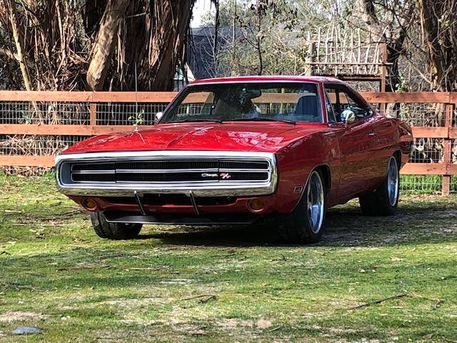

In my '55 Plymouth, it's a little vague but manageable up to about 50mph. On the interstate at 75 or 80, it requires a lot of concentration and constant correction. In the '71 Charger, it's rock solid, but I did put in a Steer and Gear box a while back, but it wasn't bad before that. It got better when I had the alignment redone to get the specs as close as I could to what Mopar Action published for radial tires.

All I have is a photocopy of the page of the magazine with the recommended specs. It doesn't say what month/year they published them. This is what they said (read degrees camber, degrees caster, inches toe-in):
L'il ol' lady -0.25, +1.5, 1/16 to 1/8
daily driver -0.5, +2.5, 1/16 to 1/8
Hi-po street -1.5, +2.5 to +3.5, 1/16 to 1/8
track day +2.0 to +2.5, +3 to +4, 0 to 1/16
auto-x (only) +3, +3 to +4, 0
drag race (only) 0 (at 100mph height), +2.5, 0 (at 100mph height)
I aimed for the "hi-po street" I think they got me almost there. Unfortunately, the sheet from the alignment shop is in the car which is at the paint shop so I can't say exactly what my alignment specs are.
