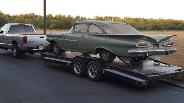

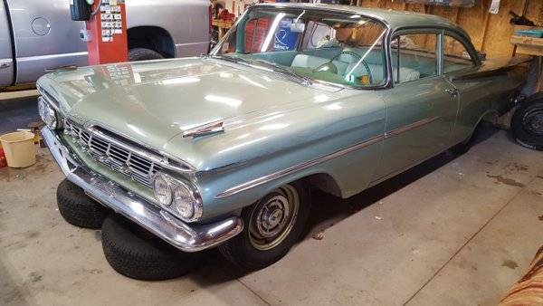

My 84 year old friend and neighbor wanted me to have HIS fathers 59 Biscayne which has been sitting in Colorado for 40 years . Well DUH.... Road Trip!! Car is Unbelievable COMPLETELY rust free, and Remarkably Intact . Everything free and in working order. So far evaluation needs , shows new fluids , the brake hydraulics, a fresh tune,and fuel. So far, just cleaned her up,inside and out, and buffed up the original laquer. 235 thrift six, 3 on the tree..... radio delete total cheapo Survivor ! Never thought I would own a Chebbie. But the price was right! I had to Rescue this Orphan. couldn't let it slip away. Don't worry, Mopar is still numero uno in my world!
Thunder
View attachment 557607 View attachment 557609 View attachment 557610 View attachment 557611 View attachment 557612 View attachment 557613 View attachment 557616
I'm very fortunate! The car Gods have been good to me!I'd absolutely love me a 59 chevy........ damn nice score
