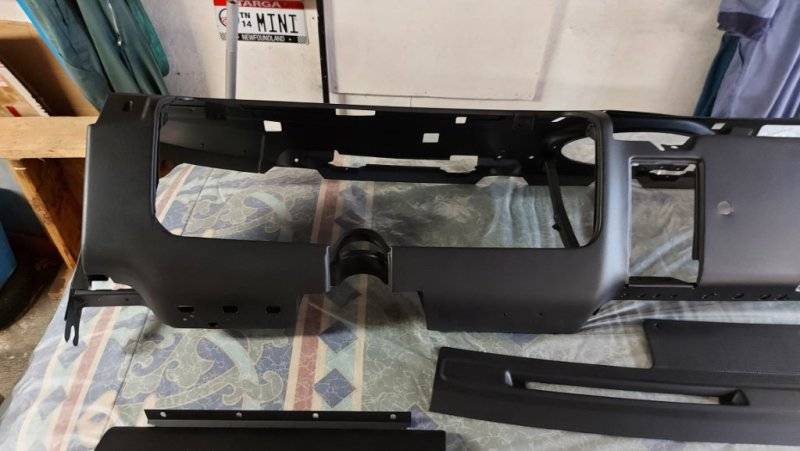

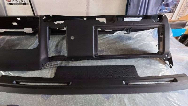

I did an e-body dash using a combo of SEM products and the Rustoleum textured black pictured above. SEM self-etching black primer followed by a very light fogging with the textured black, then top coated with SEM Trim Black. Great results. SEM paints go on really well and are easy to use.
