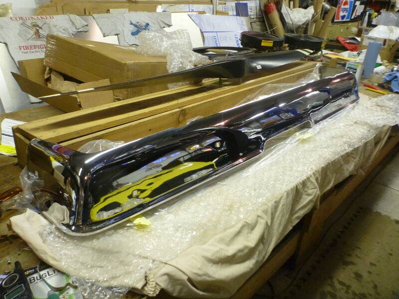

I've been told that the bumper my car came with is off a 65. Anyone ?
Could it be from a station wagon?
64' Polara 440,330 same as 65' Coronet. those bumper guards where an option.
One of my 65 Coronet 500s had those bumper guards. They are not seen very often.
It's the "V" to the lower center and the extra center bumper bolt that's got me...
1964 Dodge 440 / Polara bumper
I didn't notice the extra bumper bolt, wonder what that's all about?
That bolt has pushed the bumper out. i'm gonna have to go under it and shoot some pic's. I guess when i start on body stuff i'll make someone a smokin deal on a slightly bent bumper.

Got under it yesterday. It's just bent with a bolt in it. My valance is there with no sign of a hitch.
