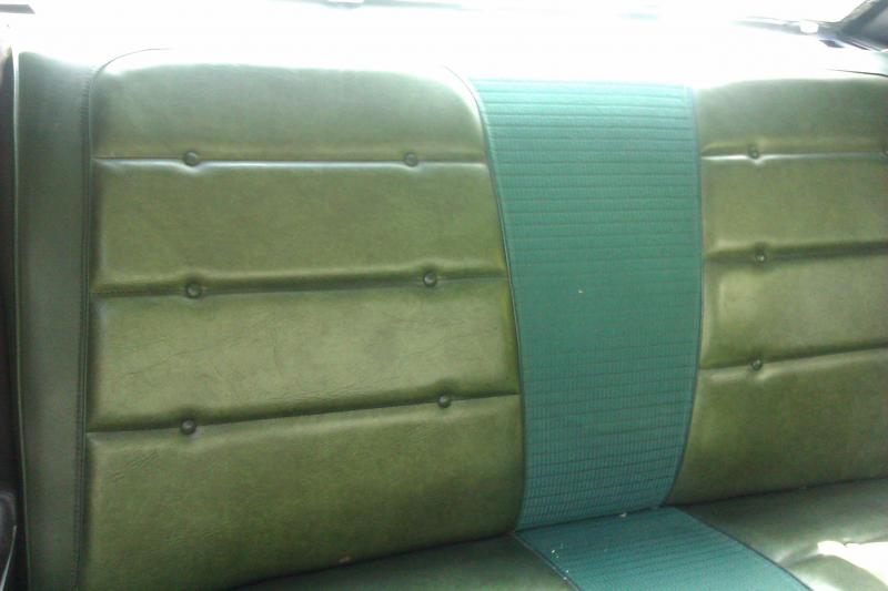

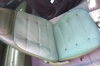

Can anyone tell me what these seats are out of? the are currently in a 72 charger but they are not origin to the car I was told.they were out of a 70 charger but I found this set online and they do not look the same http://item.mobileweb.ebay.com/viewitem?itemId=221159526328&kw=221159526328 if.they are out ofa 70 charger will this set work?
Sure looks to me like 73/4 charger roadrunner. The cores and foam should interchange 71-74 I think only the covers change.
Go to the hamtramick registry for dealer pics of the interior options of those models
70 Charger will have the 3-piece backs with the metal hinge covers and also will have different tracks than 71-4B.
Those look like 73/4B covers.
If the tracks fit your 72 floor pan than your good to go. Just get 72 covers.

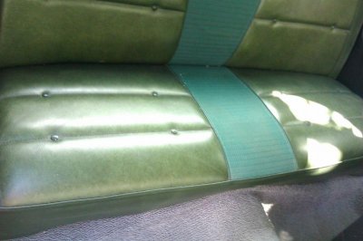

Same with the rear. Looks like a 71/4 frame.
