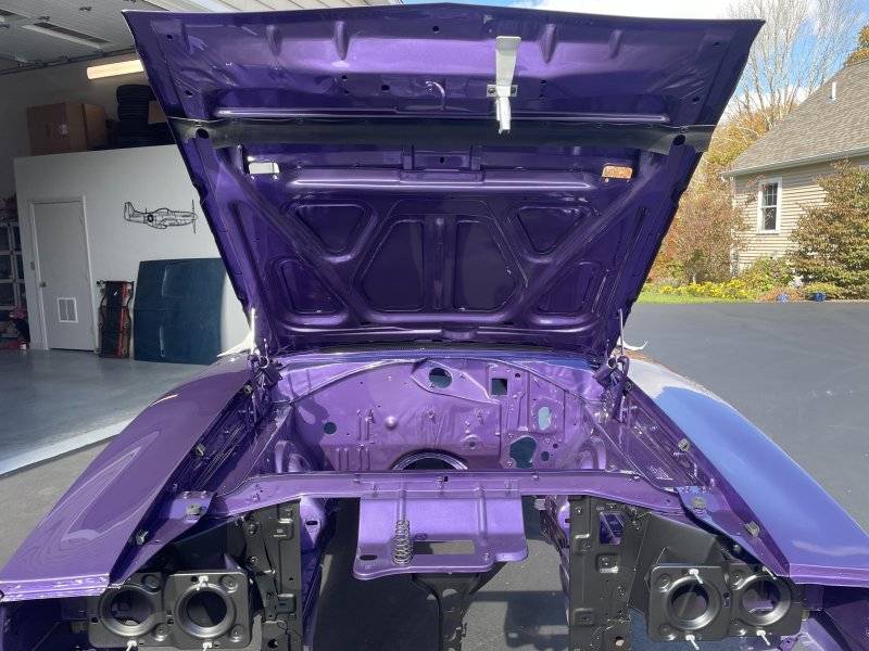

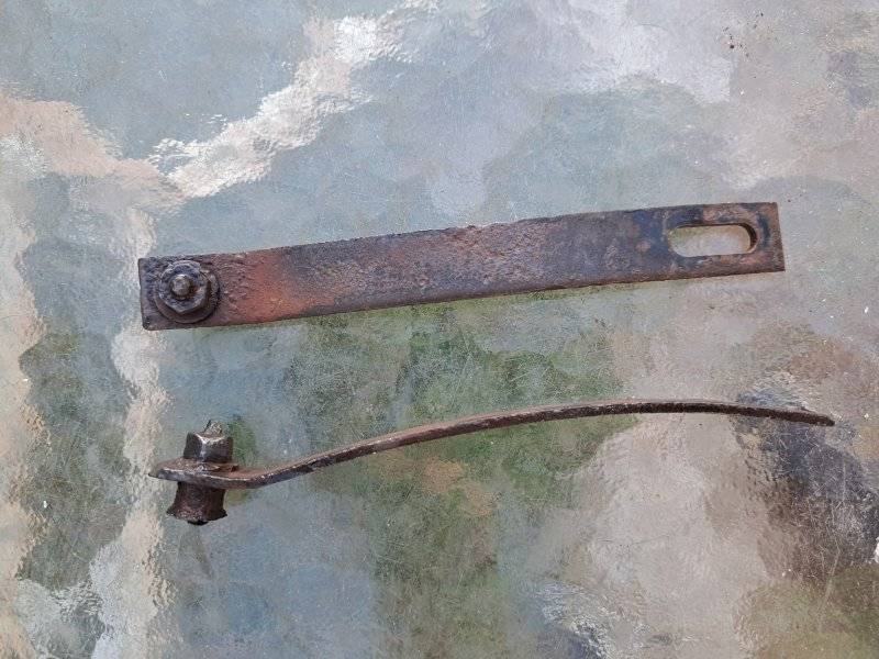

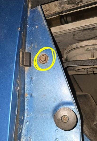

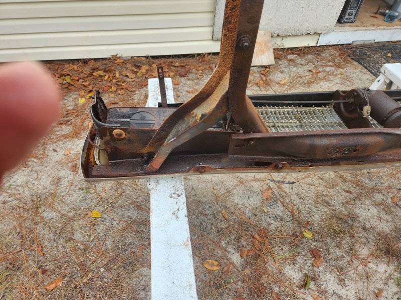

Well I have no clue what it should look like since rust ate it.Top, follow saw horse , seems one end is washer with 7/16 head then threw bracket with 7/16 nut. Top side of grill
Once again factory manual does not show the bracket. 1 on each side off grill.

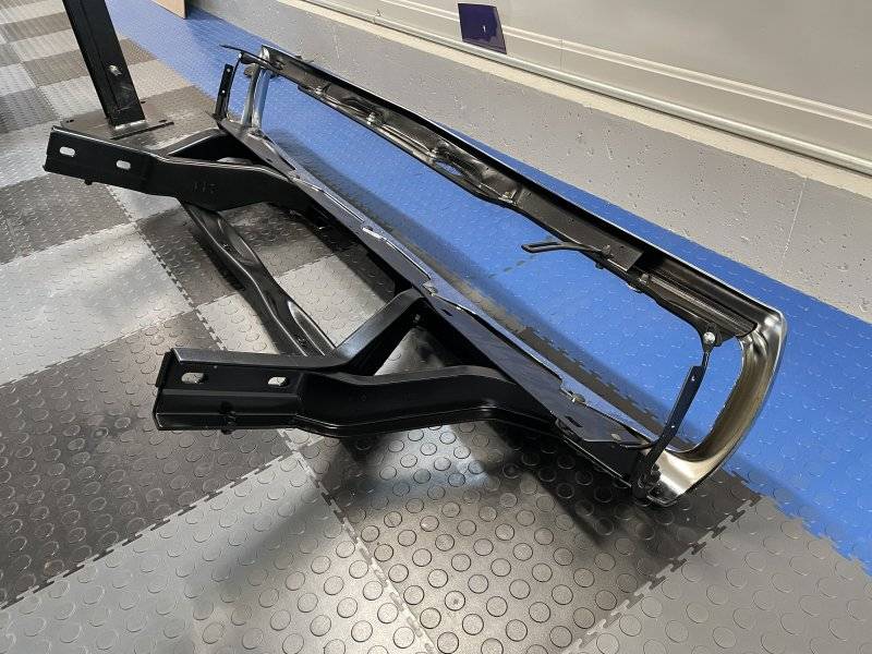

You really need to get a copy of the 1970 Dodge Chassis Assembly Manual. Reproduction copy by FAXON.

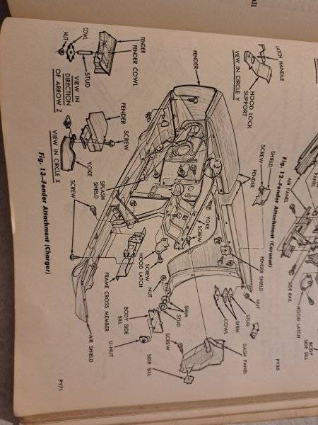

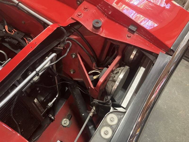

One end of the bracket attaches to the underside of the fender at the location shown below.
Left side shown.
Right side similar.

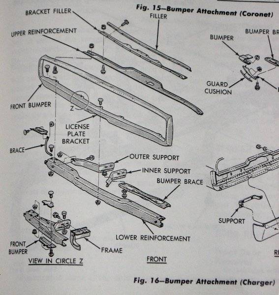

I don't have a picture of the strap in place, but here it is on the bumper...
And it attaches in the bolt holes next to the very front hood bumper....
