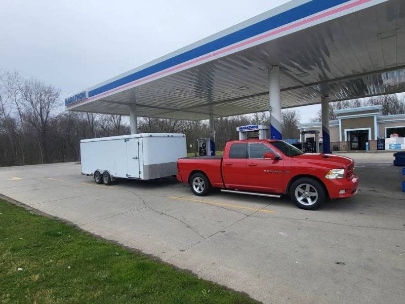

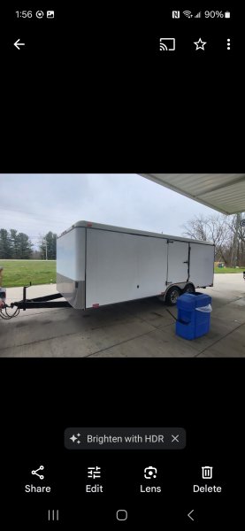

I have a 66 Satellite. And a 20ft enclosed.
It fits . but can be a little snug to get in front to tie it down. BUT, IM old and fat so its probably not all the trailer sizes fault
And the street side exit door is a HUGE bonus
In this picture, The car is a little farther forward than I usually load it.
My stop blocks have it farther back about a ft ( it tows better there )
A 22 ft would be better, and a 24 would be max I would go .
Keep in mind size of the tow vehicle should be a considering factor as well. A 20-22 would be the max I think I would be comfortable with behind my Ram 1500 gas motor truck

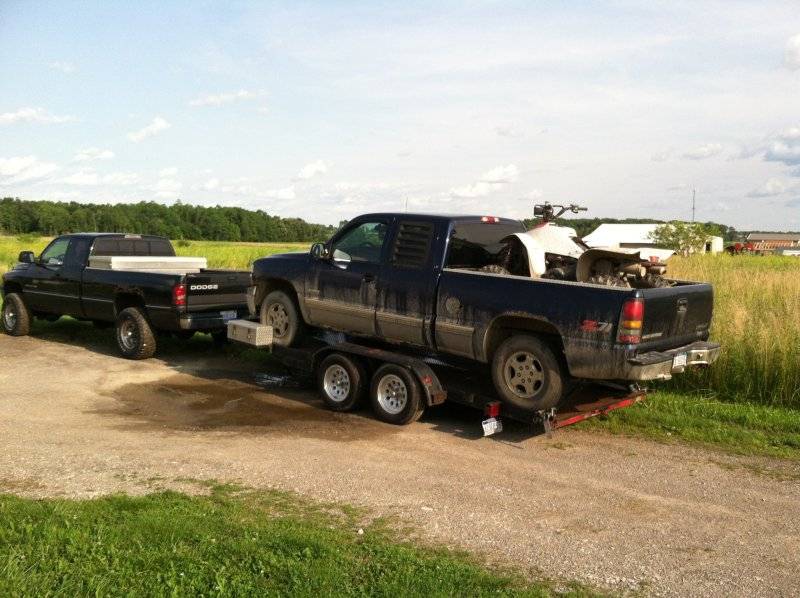

20' seems awfully big to tow with a 68 Charger... Maybe a dirt bike trailer or a jet ski trailer.... A 20 footer? Really???

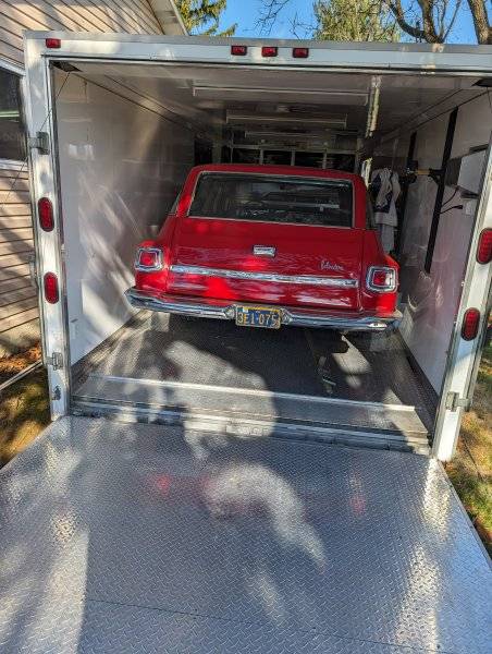

here is a couple pics of my 64 Belvedere in my 24' trailer. I probably should have got 26' or 28'. trailers are like garages, never enough space :)

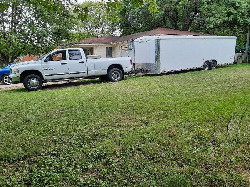

I have halled Chargers and other cars on my 18' open, my work 24' enclosed and now with my 28' enclosed trailer. The bigger the better.

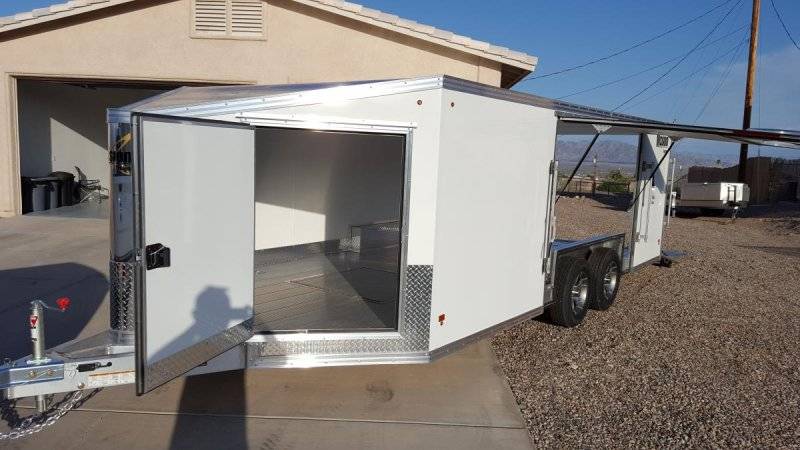

Have enclosed and open trailers hauling Chargers and a Daytona. As others have said, be sure to get the "escape" door on the left side so you can get in/out of the car in the trailer. One thing I added (wasn't an option with the manufacturer) was "ramp overs," these were 12" wide diamond tread aluminum panels on top of a 2" x 4" wooden frame based on the cars track. This males it much easier to tie down the car in the trailer, and the extra height does not affect the CG of the trailer that much. Agree with others to get a "vee" nose trailer, better milage and more stable when the big trucks go by. Heaviest axles you can get are a good thing also. Good luck.
