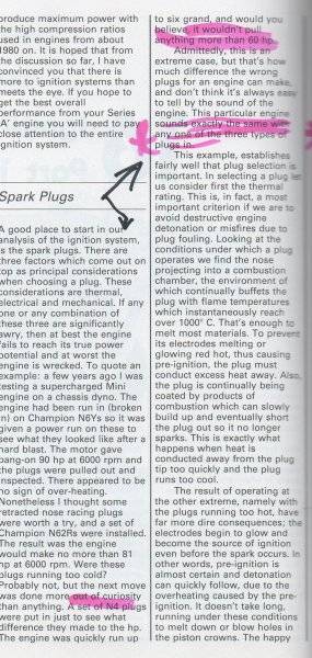

A misfire caused by a rough idle due to excessive cam overlap is going to produce less hp than an engine with a smooth idling cam, all else being equal. This is reflected by an increase in idle rpm, the rpm increase due to the engine making more hp. What is typically seen is the inverse of this: a hot cam is fitted, engine fired up & idle speed has to be increased for the engine to keep running. Engine will stall if kept at the original idle speed because it is misfiring & not making enough HP to sustain itself.
Below is test by D. Vizard where a change of spark plugs caused a substantial loss of HP.
Bob,

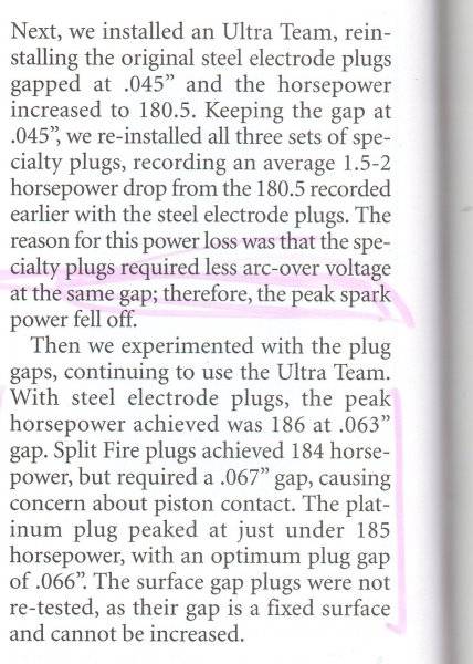

To answer your questions, I would say this: The better the ign system, the less a change of spark plug design would make a difference. Ign systems are far from perfect & the fact even in the twilight years of the petrol engine engineers are still experimenting with improving ign [ post #25 ] shows that some think 'outside the box'.
The test below had no misfires but HP increased with a larger plug gaps.
