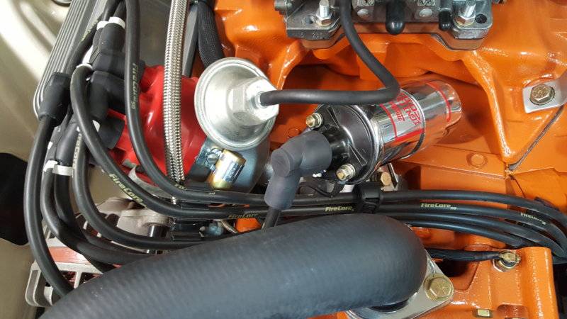

My 440 did the exact same thing. Thought i was running out of gas, tried to backfire then quit. It was the condenser. It was acually fried with the brass case having a split in it. They are known to do this on these distributors. I bought two new ones, Mallory brand for the right ohms and lead lenth (they have a longer lead than anything else out there). Replaced it and it ran for about two minutes and died. Installed another one and its been running strong ever since. You can bench test the condenser with an ohms meter but sometimes they have to be hot to show a low reading. Always keep a spare!

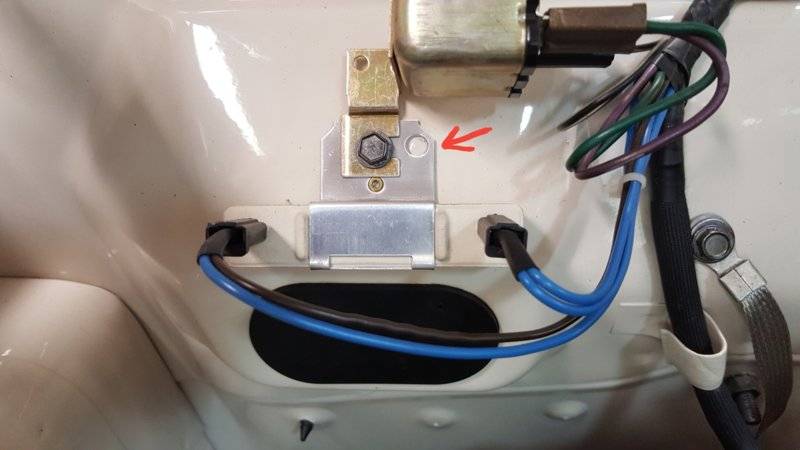

I'm useing the 401 condenser, 29217 coil and the 700 or 8214 ballast resistor (depends on which one looks period correct). The distributor is the older 2757801 NOS.
Useing this Ballast I drilled the hole in the bracket for the dimple in the firewall.
My Mallory is a mechanical dual point, takes condenser #400. Ordered 4 of 'em from MSD. Irritating...many of the damn parts out of China.

Not yet, moper. Besides being too busy to get in the shop, waiting for the condensers I ordered to come in. Then I'll pull the distributor, and check everything. My initial thought was the condenser, though the smoke threw me. I'll know in an instant, once I pull the cap, and look at the points.
