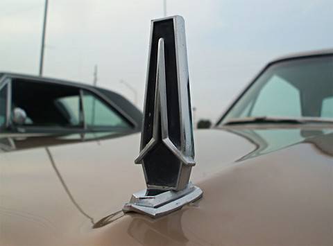

Can anyone tell what kind of paint to use to touch up the black accent detail on hood ornaments and emblems? See the attached photo. I want to re-do the black on hood ornament and "PLYMOUTH" lettering on the hood of my '67 Belvedere. My concern is the paint flaking off an account of paint not sticking to chrome very well. (The emblem in the photo is not mine. If mine looked this good, we wouldn't be having this conversation.)

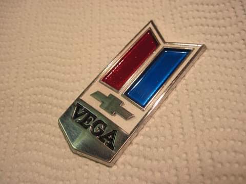

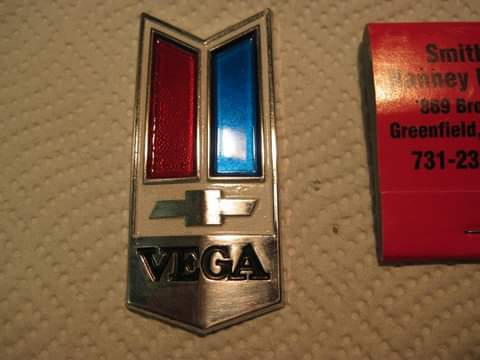

Though thicker pieces aren't always conducive to the process, I've had good luck powder coating them, even in multiple colors. (Matchbook was included to show the scale.)
While shooting the pics the battery died. When I got back to my bench I found this ... he can be such an a$$hole LOL
Thankfully in the 11 years since, he's back to Mopars now.

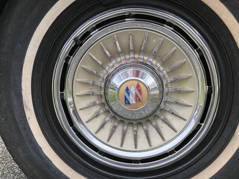

I did some Buick emblems using Testors Enamel paint, looked great. These centercaps are lexan and I cleaned all the flaking paint off them and painted them on the back so the color would show through. Look like brand new! The Gold background was hard to match and I think I got pretty darn close.
Very cost-effective!
